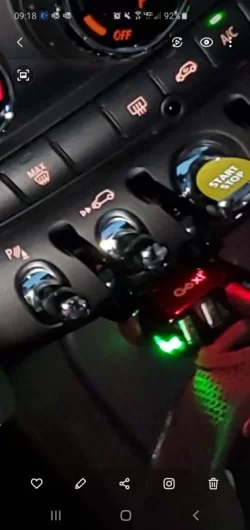

Not related to this thread, but I see from your picture that you have the iconic trim. I also see that you have a switch where my Sig+ has a gap. That switch to the far left, in the row with the power switch - what feature does that control?
I'm wondering if I can get a dummy switch and throw one of those stickers on it...

The SE does have the ability to apply reverse torque at speed to regenerate energy by releasing the throttle. You must have it turned off in your Mini, there's a switch next to the on/off switch that lets you toggle it. And the issue we're having here is not that we can't shift at speed when we're doing a J-turn, it's that the car acts like it's in neutral for a few seconds after coming to a stop and shifting.
