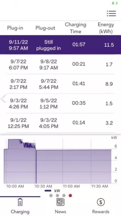

So I had a fully depleted battery and set the JuiceBox at a 40Amp charge rate it began to chatter within 30 min or so. Stopped the charge and reset to 24 Amps, no chatter. I’m considering that the fix.

I have a dumb, non-configurable 48-Amp commercial ClipperCreek EVSE. Should I worry that I can't generate a graph that warns me about this horrible chattering?
I don’t know what’s going on when the charge rate moves up and down
(Chatter). I saw no change in my car’s performance at all. It’s possibly completely normal behavior for the onboard charger. Lowering the rate seems to eliminate the chatter.
I'm not sure of your situation but I see the "Chatter" you are talking about on hot days when the fan is running during charging. Mine has always acted that way on hot days so I don't worry about it.
