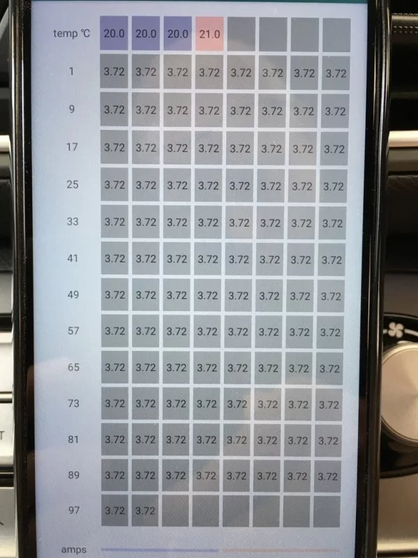

Also, for RP, don't panic if you see some at 0.02 difference because it can show that if the SoC happens to place the voltages right on the 0.02 granularity boundary. In this case all I can say from this image taken just now is that all cells are between 3.720 and 3.739, a variation of ~0.02 max. The cells could have been all exactly 0.010 lower, technically just as good at 3.710 - 3.729, yet looked like a complete mess because SoulEVspy alters the background colour when the voltage is different from the majority by one step.
We're really looking for differences much larger, like 0.10 V. Hope that's clear ...

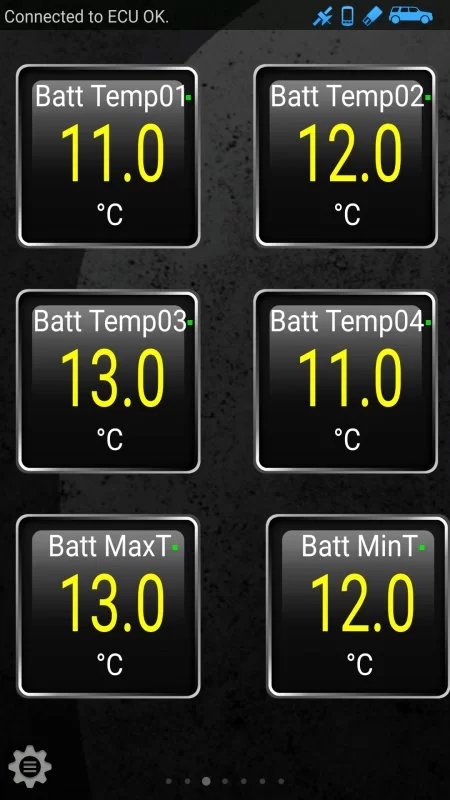

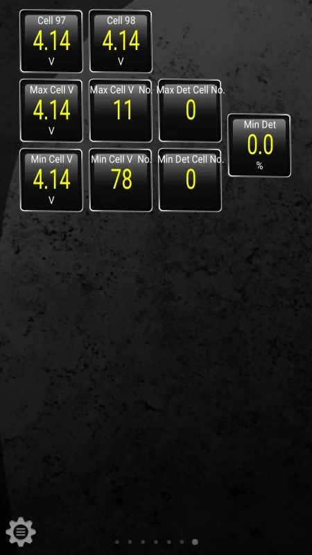

AC (7.2 kW) charged my car last night to 100% (Plunge pricing for my electricity last night so I was being paid to use electricity!)

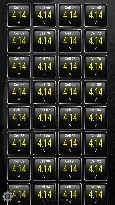

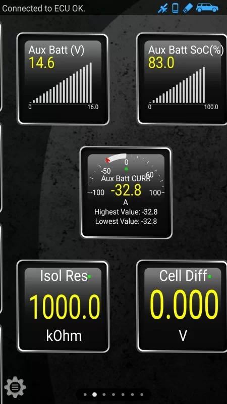

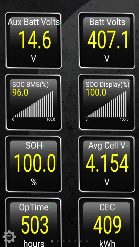

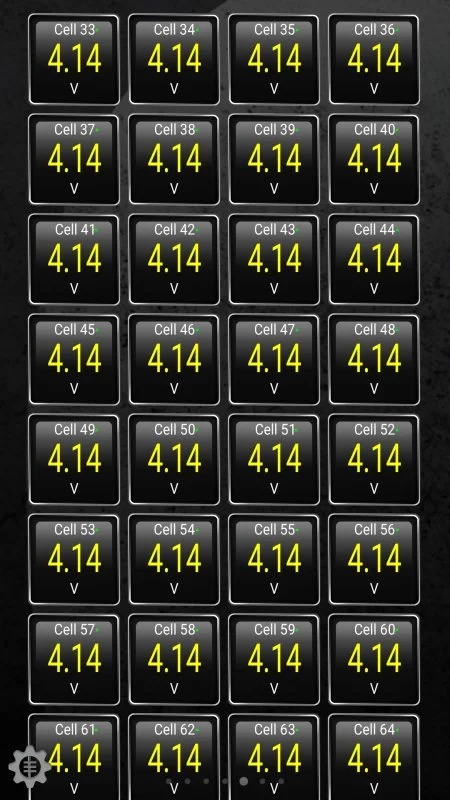

Sceen shots from Torque Pro
Same here charged up to 100% for a third time in last 2 weeks, been driving longer distances for work and need the range since the temperatures have dropped with overnight lows around -4C. Everything looks good. Pack is balanced out nicely ,no cell variation(min and max cells at 4.16 V with total pack voltage of 408.7V). I even saw a 94.5% BMS SOC at an indicated 100% displayed last charge session , that is even better than when the car was brand new, suggesting zero degradation over the past 18, 000 km/ 10 months. I agree with Anaglypta I think the 960 update is already appropriately monitoring the cell variation and am not worried that it won't provide sufficient warning . I kind of feel the only thing the pending update will give us is longer charge rates after 80% SOC.

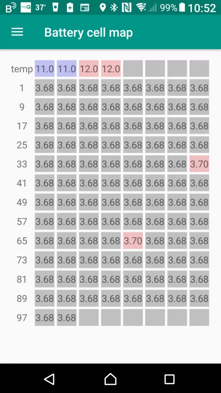

Got my dongle yesterday and tried it out today with soulevspy. I first verified the connection with the Lite version, and then also verified it with the ELM327 Identifier app to confirm that it was not a fake. All good. So below is my current cells status. This was done when the car was at 59% charge (as per car dash). Two cells are at 3.70, rest at 3.68. As I understand it, this is OK, with .02 variance not a concern. And again, have never charged my car to 100%. Car is being charged again as I write this post, so will do another check after that.

Looks pretty good considering never charged to 100% for top end balancing:)
