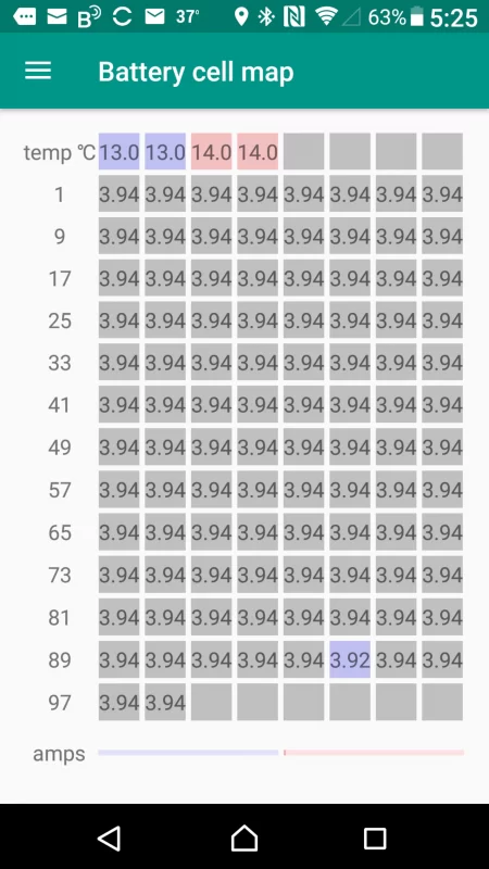

Another screenshot of my cell voltages, SOC is at 78% now.. This time one is .02V less, again within the measurement accuracy variance. So I guess all is good.
Your 94 is my 57, a lagger. Overall, I think it's just fine and I'd bet most Kona EVs would show a similar deviation. Also note that cell 94 could be 3.939 and still read 3.92 due to (digital) truncation.
Although on the prev screenshot it was the same as the others. The developer said that .02 is the accuracy variance, and it is normal that at different times, different cells can show that discrepancy.

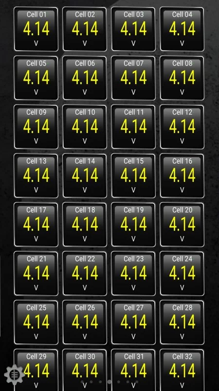

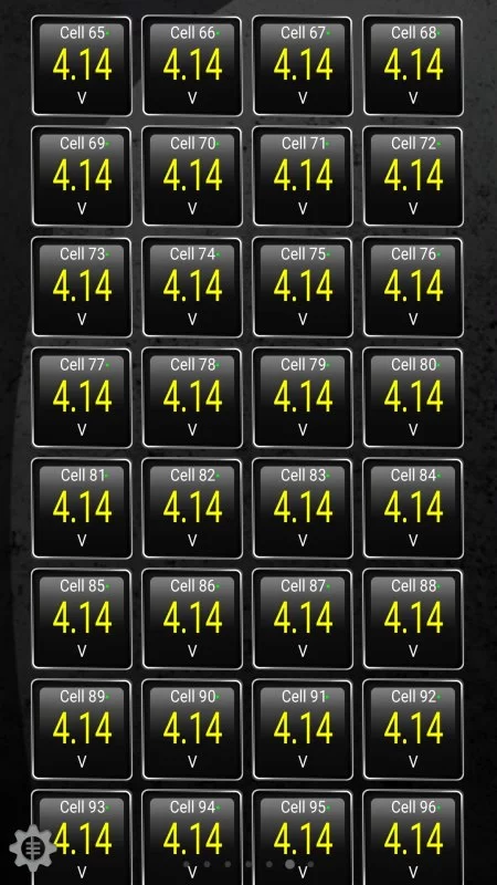

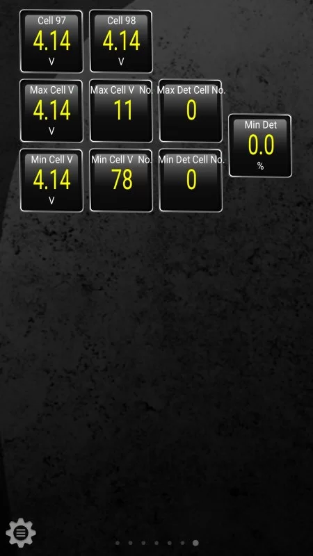

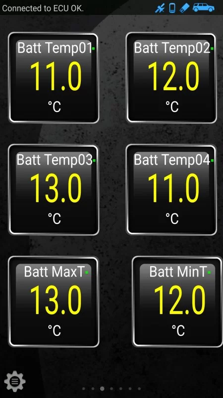

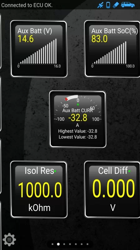

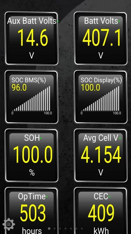

AC (7.2 kW) charged my car last night to 100% (Plunge pricing for my electricity last night so I was being paid to use electricity!)
Sceen shots from Torque Pro
View attachment 9682 View attachment 9683 View attachment 9684 View attachment 9685 View attachment 9686 View attachment 9687 View attachment 9688
Your voltage is nice and low.. Mine shows 4.16 volt at 100% but it has to be over 4.17 volts as my total pack voltage is 409 volts but I do have 38300 miles on my Kona.. The good thing is that my cell variation never exceeds 0.02 Volts..

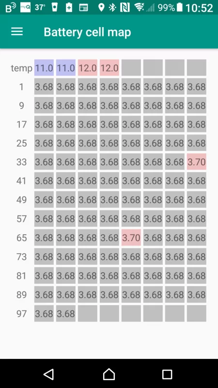

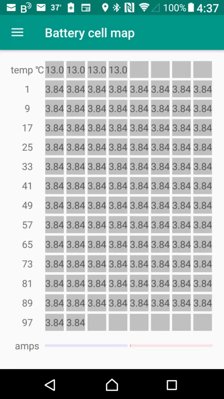

Took another screenshot today, and probably the last I will post for a while, unless something drastically changes. Anyway this one shows all cell groups exactly the same now. Can't get any better than that. So with that I would say my mind is very much at ease now, thanks to SoulEVspy, and to those that recommended it. Certainly very quick and easy to use.

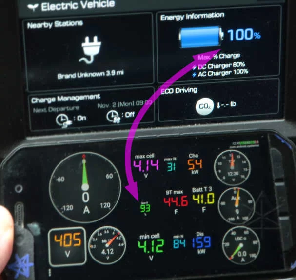

A couple of days ago I decided to level-2 charge to 100% and watch the latter stages of it
closely in terms of cell deviation. Normally the DC current going into the pack runs around
18 - 20 amps, which is a 0.1C rate for the tripled-up cellblocks. As it approached the top, the
OBC dropped current down by degrees and it was only 5A just before terminating. Once
finished, the "real SOC" was still well under the displayed 100% ...
but even at the top of charge, the high/low cell figures were never more than 0.02V apart.
This is just afterward, with my phone running my usual OBD2 "dashboard". I have *not* had
any BMS firmware updates so far, for a handful of reasons including that I don't trust any
of the local dealers to not screw it up. I can watch for hazardous conditions and limit
extremes on my own for now.
I misspoke about full-charge voltage in some other post, where I said it stayed under 4.1V.
Clearly it goes a little above that but frankly, I wouldn't start worrying until something rose
over 4.2. If I stay at displayed 80 or 90% for normal charges the cells will rarely crest 4V,
unless something goes really wrong.
I saw nothing that I could identify as active balancing during the top taper, pack temps
remained about the same as ambient, and the charger and VCU/motor assembly were the
usual warm as the charging system runs the coolant loop through all of that when working, due
to the 10%-ish inefficiency producing about 700 watts that need to go somewhere. There
was no warmth at all in the hoses connected at the front of the pack.
I found that enough electronics power up during charging that even with the car "off", I could
talk to my bluetooth OBD2 dongle -- from cozily inside the house, yet, and watch the min/max
figures slowly progress upward. The cell *numbers* for each also did about what they always
do, settle on 1 and 84 with occasional blips to something else on one scan cycle. Per the other
Torque thread, I'd love to learn how those figures come up for other OBD2-jockey owners.
_H*
I've had no BMS updates either and I've never witnessed cell balancing take place, at least I'm assuming that's the case because it always jumps suddenly from 98% to 100% on all the half dozen times I've both charged that high and kept an eye on it. I'll assume also that charging current goes to zero at 98% such that an assessment of cell-group voltage can take place without being disturbed by charging current ripple.
I'd have to guess that somewhat more than 0.02 V imbalance is required to kick off the process and mine has always been in that range, 15,700 km to date. Cell 57 has been the only lagger at max 0.02 under, but if the values are truncated then technically the difference could be pushing 0.04.
At 100% SoC(disp) I'd normally see 94.5% SoC(bms) so 93 shows plenty of room, noting that you can add a single decimal place to your displayed value. We know that others have seen 95.5% or slightly higher.
Yes, the OBD port is responsive during traction charging, Run and Utility modes. And, almost certainly during aux battery saver events but I haven't verified that. TP can be set to start logging automatically when it sees the port wake up, which can be useful in some cases.
