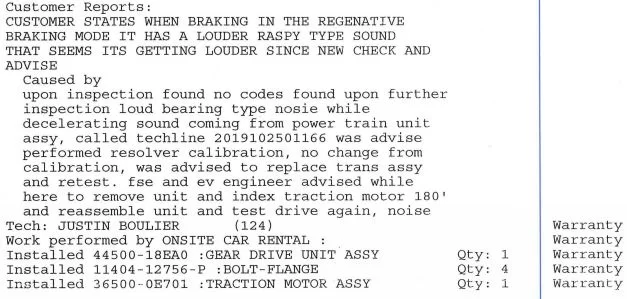

Well mine didn't have it at new, and now at 7,000Km or so I can hear the hiss as long as I've got the windows down, the VESS off and I'm in a car park next to a wall. I'll bring it to the dealer's attention at the 15K service, if only so that I have a written record of reporting the problem. We'll see what happens. No other odd sounds.... yet.
I’ve recently passed the 5,000 mile mark on my Kona, and the sound that began around 2,000 miles has become much louder and nearly constant. At low speeds it sounds like something rubbing rotationally. At high speeds it sounds more like a whine, or a jet engine when I floor the accelerator. This sound happens on both acceleration and deceleration, regardless of the level of regenerative braking. I can even cause it to appear and disappear with variable acceleration or deceleration.
Colin, is this the same sound that you experienced? I haven’t taken it in to Hyundai yet, but I’m going to soon because it’s starting to drive me up the wall.

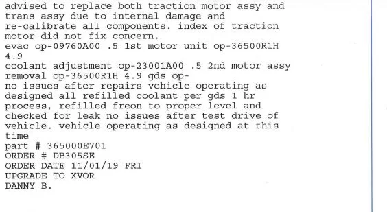

No, I experienced it only on coasting to a stop, thought it was the regenerative breaking. Very much sounded like a bad bearing. Almost like a roulette table slowing to a stop.
WHAT?
They replaced your gearbox and motor and now the sound has come back????
I worry that this could be a design flaw with no easy fix rather than a defective part. Either way, I hope Hyundai does right by its customers and handles this issue appropriately. So far, there’s no indication that they’ve actually concluded or acknowledged a systemic issue.
The lower gear drive replacement to fix the noise issue did not work for other owners. I suspect it's the actual electric motor causing the noise. Other owners also have this noise issue around the 9000 mile range. I'm only at 3000 mile and it's starting to be quite noticeable driving with the windows down. When it gets to the 9000 mile mark it's so loud that it can be heard with the windows up and the music on. I think they will have to replace the motors on most of the EV's in the future.
