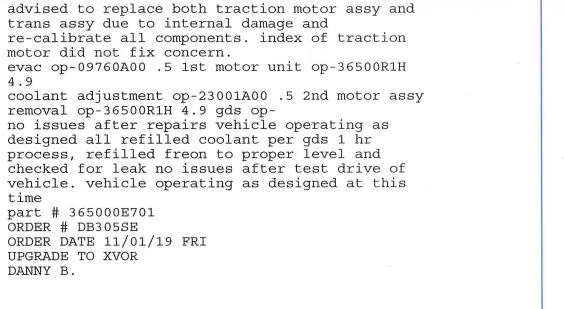

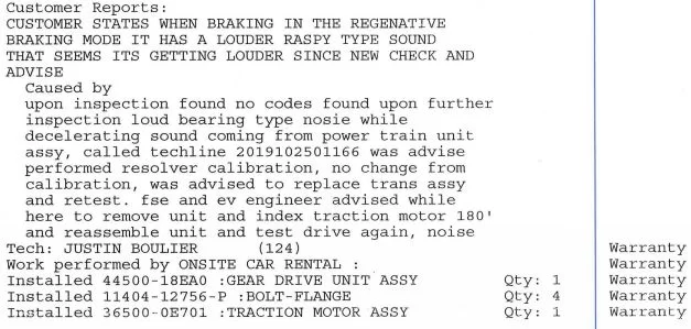

A quick update on the process and resolution. The car was finally repaired (4 weeks in total). Below is a quick summary of the resolution. Will keep you updated, but Hyundai came through and reimbursed me for two months of car payments.
Could you clarify what was the actual fix to the problem?
It looks like they tried to replace the lower gear drive first and it didn't fix the problem so they ended up replacing the electric motor which had internal damage.
Is that correct?
View attachment 6884 View attachment 6884 View attachment 6885
Thanks for that, first actual paperwork I have seen posted listing the motor, gearbox and (mounting bolts?) as replacement. :)
