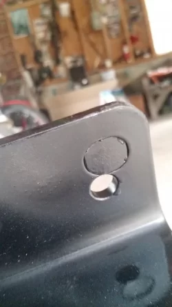

IMG_20200312_131316983.webpI installed the Curt 13329. Rather than extending the holes I filled existing holes, then drilled new ones. Re-installed aero panel with minimal modification.

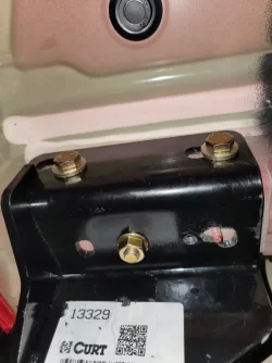

I've got the Curt hitch on order, arriving Wednesday. Prefer 2". Planning to try with the panel left off and holes drilled into the hitch rather than cutting off the two studs from the vehicle that attach the panel.

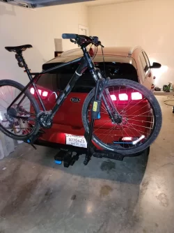

I was able to fit my 29" XL frame mountain bike (with front wheel removed) inside the vehicle with only a little effort though. Still going to install the hitch for the bike rack.

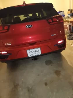

Curt 2" installed. Didn't have ideal tools to move the holes. I ended up moving the two holes on the side and the one for the bolts from the aeroguard to fit. No mods to the vehicle itself.
The aeroguard looks like ~$100 to buy a replacement. Might modify mine to fit the hitch -- I think it looks like it would just need two slits on the ends and the square for the hitch and it would fit (the main "bar" looks like it would fit without modifying the panel). For now I just have it left removed.

Also, what bike rack is that?

It looks like I moved the holes to a different place than the poster above me, I wanted the bracket to sit directly against the frame.
There's also an "extra" hole for the stud in the wrong place because I was initially trying to place it differently, and that's the first holes I drilled. I basically extended the three slots (the two on the sides, and the one for the studs to fit).
Rockymounts monorail solo.
https://www.amazon.com/RockyMounts-MonoRail-Expandable-Platform-Bicycle/dp/B076WTCZD5
