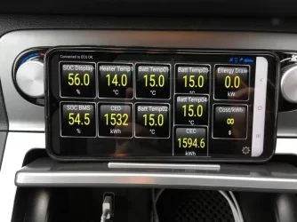

Running Torque Pro on a Niro EV using pids from jejusoul (this is best discussion for the Korean EVs). I recently noticed that TP can't correctly read the SOC (display) after I've fully charged the battery for a trip. It is stuck on "-0.5%". Once the SOC drops below 60 or 70%, it will be correct after restarting the app. BMS SOC is correct, and the car's display is correct.
Any ideas??
TIA

Update: added the ABRP-labeled pids from GitHub, and it seems to work now (n = 1).
Sent from my Pixel 3a using Tapatalk
The ABRP SoC pid just calls the 003_Kona&Niro_EV_BMS.csv SoC pid, so perhaps you just needed to reload/replace.
Either way, problem solved...
I agree. Still curious how the pid stopped working after months of normal behavior. Corrupted maybe? How?
Oh, well, one of life's mysteries [emoji6]
Well, NM. It's broken again. Happens with both the ABRP pid and the original Jeju pid (which uses an actual formula according to the editor). None of the other pids are affected. Happened after I removed the OBD dongle and reinserted. I'm open to any ideas as to what's happening. I'll check the greater Torque discussions, too.

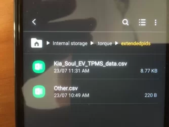

Transferring Torque Pro configuration to a new phone:
I just upgraded to a Samsung Galaxy S21. Samsung's smart transfer process moved the Torque app, but didn't copy the configuration from my old S7. I suspect it's because the .torque folder is semi-hidden or protected. Here's how I did it on a Windows machine:
  1. On the old phone, using File Manager, rename the .torque folder in the phone root to torque. This makes it visible to Windows.
  2. Plug the old phone into the PC.
  3. Create a file torquexfer on the desktop.
  4. Using Windows' File Explorer, copy the folders inside the renamed torque folder on the phone into torquexfer on the desktop. I chose to omit tripLogs, which can be large. (Windows wouldn't just copy the whole torque folder; it must still have some protection.)
  5. On the old phone, rename torque back to .torque, and unplug.
  6. Plug the new phone into the PC.
  7. Copy torquexfer to the new phone.
  8. Delete or save the folders inside .torque.
  9. Copy all the folders in torquexfer into .torque.
There are probably easier ways to do this, and it could be shorter if both phones were plugged in at the same time, but this worked for me.
(Hopefully) Final update:
It seems to working now. Deleted all the app data in storage, then uninstalled. Rebooted phone. Reinstalled Torque. Copied extended pids from other phone which has always worked and installed them. Had to recreate screens (left out the 98 individual cell voltages!). Had to make the calculation correction for Aux battery current.
Worked fine all morning. Broke my ABRP live data, so had to re-enter that info and designate what to log. Whew!
Thx for the support and suggestions!
