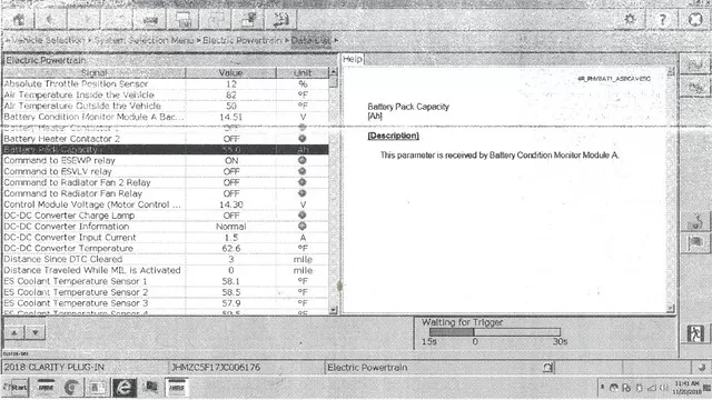

I had to insist, but finally got this screenshot verifying the test had been done and the results:
It prompts another question from me (i.e. maybe my experience really is abnormal)--does your car ever increase electric range, even a little bit, in HV mode? I don't mean long-press.-Dan
