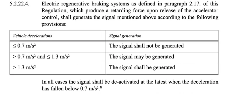

There are specifications to which the cars will be constructed.
This is from https://unece.org/fileadmin/DAM/trans/main/wp29/wp29regs/2018/R013hr4e.pdf
UN Regulation No. 13-H
Uniform provisions concerning the approval of passenger cars with regard to braking
I suppose the rate of deceleration will vary depending how loaded the car is, which would be why there is the "may be generated" band, so it wouldn't directly correspond to a particular regen level under all conditions.

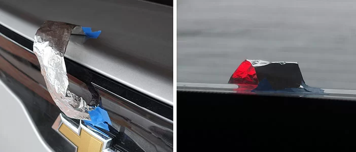

I took a suggestion from someone on this forum by taping a piece of foil over the center brake light, making it easy to see even in daylight. I found the brake lights come on at some point between the 2nd and 3rd bar of the regen indicator. They also light up about a second after the regen paddle is applied.

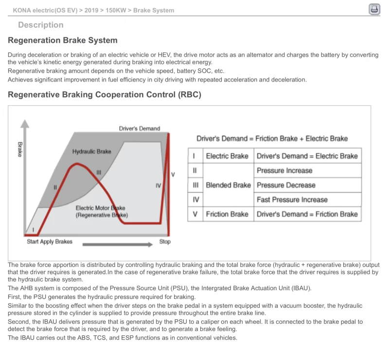

My original rant about exploring this is here, and the thing to especially note is the "downhill
hot rotors" test. Even a small amount of hydraulic pressure would generate perceptible heat.
Note how the lighter-gray area around "I" in the above chart doesn't enter the blended area;
that's what I mean by "gentle", which implies good predictive driving. That still gives you over
50 kW of recapturable slowing power with very little loss, and whether you get that with the
paddles or the service brake it pretty much doesn't matter. Hyundai did a nice job on this, what
I cynically call a "Prius-grade" bit of engineering since that was where I first observed strict
avoidance of the hydraulics wherever possible.

To see when your brake light comes on, consider installing a temporary indicator using this technology, which I developed six years ago for my Volt:
Parts list:
  1. Aluminum foil
  2. Blue tape
Use with caution, as it requires watching the rear view mirror. If I were going to try it today, I might add a viewer more in my line of sight by taping my pocketable camera to the dash and making use of its telephoto lens and 180 degree flip LCD.

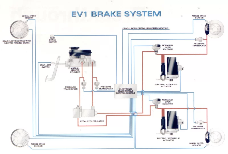

I was surprised to learn a while back that GM's EV1 used this idea and perhaps was the first to do so. Here's a description:
