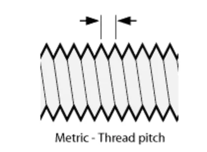

I thought the 1.5 is the length of the bolts, which must be .25 inches longer than stock to account for the thickness of the spacer. Am I mistaken?
So, MINI being European use metric sizes
M14 is the thread size ie, measurement taken across the outside diameter of the lug bolt thread.
The 1.5 or 1.25 is the thread pitch which is the distance in millimeters between the threads for metric applications.

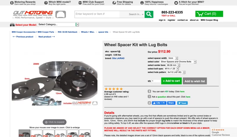

To compensate for the width of the spacer, we need to get bolts with longer shank length. The outmotoring spacers come as a kit with longer bolts matched for the width of the spacer.

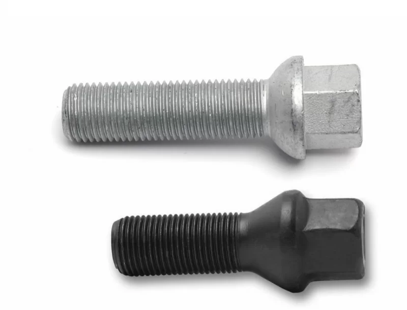

Another thing to look out for when buying stand alone lug bolts for wheels is to make sure they are the right seat type ie, either conical or spherical. I believe most after market wheels require conical bolts while OEM ones can be spherical. See pic below

I would rather go with prematched spacers and bolts for MINI from outmotoring or similar websites to take the guess work out.
