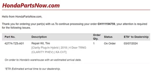

I guess I didn't beat the avalanche of orders that descended upon HondaPartsNow after @Johnhaydev's post.

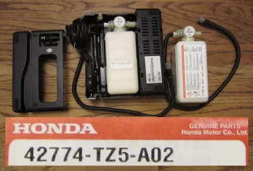

I was happy the bottle is so easy to replace. The cover slides off easily after removing the power cord from its cavity. Then, after threading the hose out through the hole in the case, you just tilt the bottle all the way up to disengage the connection locking tab and pull the bottle away from the compressor connection on the right.
Does anyone want my 6-year old, never-used OEM bottle of slime? I'll toss it next week unless someone PMs me first.
Whats the expiration date on it? I hope it is not an old one.
The "old" one I'm willing to donate from my November, 2017, Clarity is the one on the left in my photo with the "EXP 02/2024" sticker on it. So it officially expired last month, but I don't know it the carriage turned into a pumpkin on the 29th. Interestingly, I didn't see an expiration sticker on the replacement bottle, so I made one up that says "EXP 03/2030."

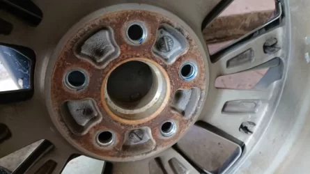

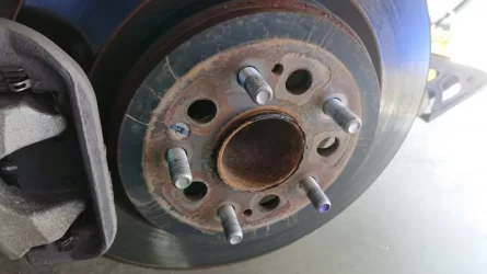

This past weekend, I had a piece of metal puncture a tire and when I attempted to screw the plastic/metal shrader fitting of the repair kit hose onto the valve stem, I could not get it to thread far enough on to engage and allow air / gunk to flow. I am sure the gunk would have worked because later I noticed a bit of it leaking from around the hose end.
So, for those who have used this system successfully:
1) What do you do to clear out the gunk and use the compressor just to supply air again? Hold it over a garbage can, trigger the valve and hope for the best? Compressor is still under 60psi of pressure.
2) Is the gunk a one and done supply or can it be used subsequent times (particularly if the first time no flow happened)?
3) Under pressure, the device knob will also not switch from gunk flow to air flow setting.
FYI, I also had a time getting the wheel off due to rust of the hub. Against the aluminum wheel. I sanded away rust and applied a bit of grease.
