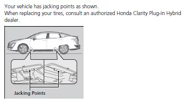

Thank you for this PDI sheet. I see there are only two jacking points, and they can't be reached by a typical scissors jack for changing a spare that didn't come with the car. Well, the back one can but wouldn't want to jack up the whole rear to change one tire. Any, very interesting read. P.S. - the fact they removed the traction battery hard fault code and made it a secret is not a good sign.
There are more accessible jacking points, as shown on page 534 of the Owners Manual:
