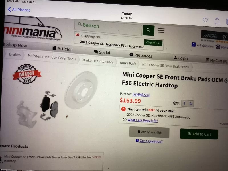

Interesting. Higher friction GF pads on the back than FF on the front. That could be why the front pads are unique to the SE, low friction. Possibly to make better use of regen braking.
If my part sleuthing is correct, front pads are same fitment as R56 and F56 Justas. I did have a set of R56 Justa pads in my basement. I will have look for them.
If these are really the pictures of the rear pads, then these are the correct ones. I just ordered them from Amazon. I'm having a hard time finding what look like correct Akebono for the fronts. But the rears are the most critical because of this dust issue.

Pelican agrees that Akebono EUR 1762 is correct for the rear, so that's a good sign. No Akebono fronts however.
I'm going to get the rears figured out first, then try to find fronts. This is the next Akebono front set that looks promising. I wish i would have taken a picture of the front pads when i had them out - but this picture looks the same as i remember when i had the fronts out.
https://www.fcpeuro.com/products/mini-brake-pad-set-front-cooper-eur1308#fitment

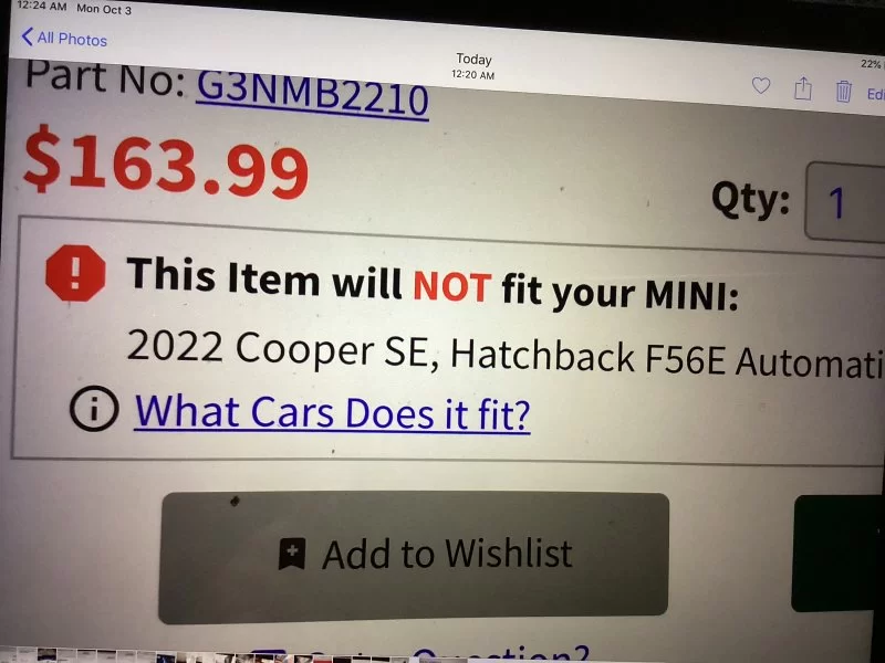

On the front brakes, when I search for the BMW part number 34106884263 from the Pelican Parts listing (https://www.pelicanparts.com/More_Info/34106884263.htm), I find some references to the BMW 2-series F45, which was never offered in the US. Quality aftermarket options seem to be slim pickings.
