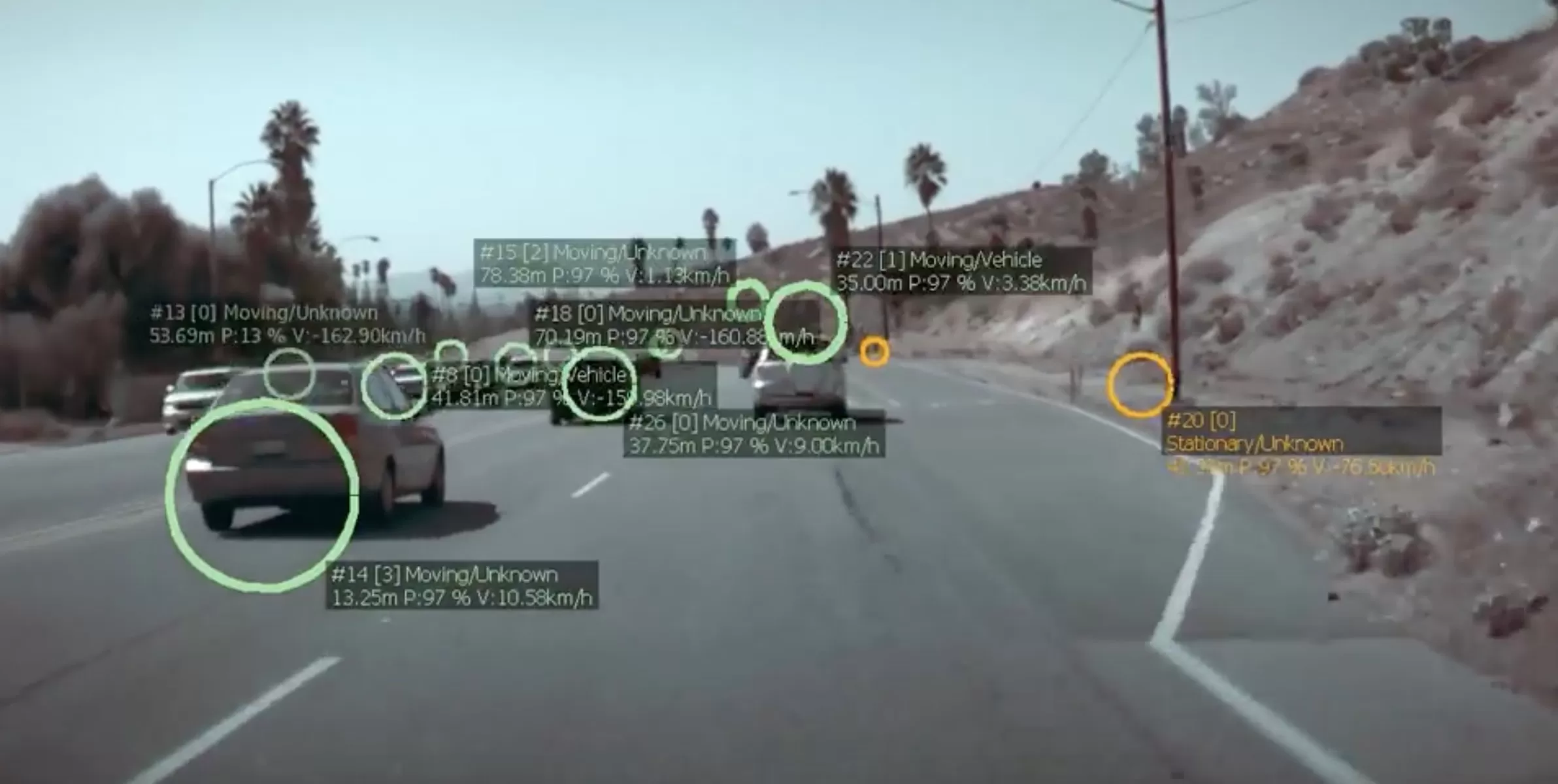

Here is an attempt to show, visually, what Tesla's low-res Doppler radar "sees":
(I'm linking to the source for the sake of completeness, but I'm very skeptical about a lot of what's said in that article. Looks like a lot of guesswork to me, and I think some of those guesses are wrong.)
Note the size of the radar return (indicated by the size of the circle) shows only distance, not size or shape. Also, note it ignores stationary obstacles such as telephone poles and trees. (A couple of objects, indicated in orange, are labeled "stationary", but my guess is those objects were first detected as moving, and are now identified according to their previously detected position when they stopped. Or perhaps at least one is a false positive, since the larger orange circle on the right appears empty.)
Quite clearly this is entirely unsuitable for 3D mapping. If, for example, there is a tractor-trailer rig pulling onto or across the highway, into the path of your car, then the self-driving system needs to know how big it is... not just how close it is.

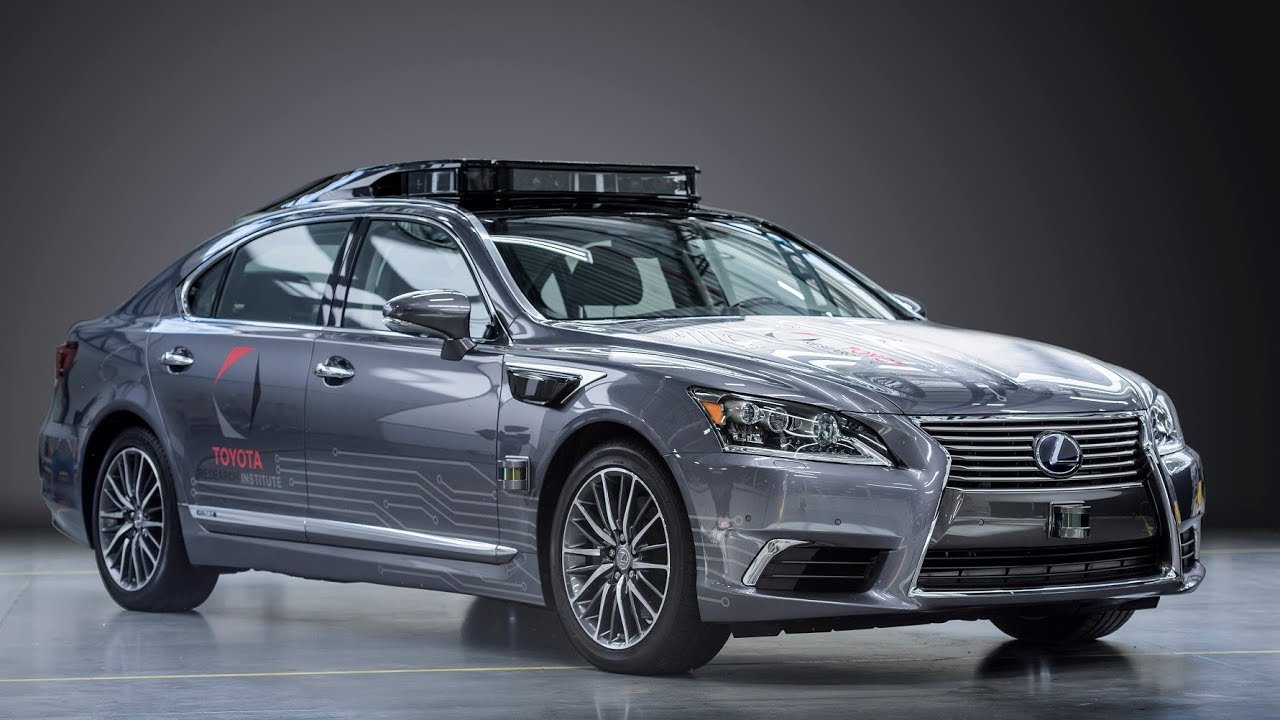

And it's stupid to put the primary scanners down near the bumper. They should be elevated as far as possible. Mounting a lidar scanner under a dome on the roof may look "ugly" to us, because we're not used to it, but that's the proper placement for a self-driving car's scanners. However, with solid-state scanners, the dome can be eliminated (see photo below).
Women and other short people enjoy the elevated seating position of an SUV or minivan, because it helps them see over other cars on the road. For the exact same reason, the primary scanners in a self-driving car should be as high on the car as possible. If that means having a roof which is a few inches thick, then that is what the future of automotive design should be. Those who find an elevated roof to be "ugly" are simply going to have to get used to it. No doubt back in the day of horseless carriages, people also found it "ugly" when auto makers started putting the engine in a metal box at the front of the car, rather than mounted over the rear axle.
Technical advances affect fashion, and often Form follows Function.
Toyota's Platform 3.0 prototype
