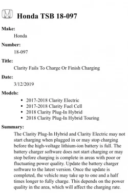

Here it is.
It is an update what Honda has labeled “the battery charger software”.
Were you expecting something different?
Maybe I'm reading the TSB incorrectly that they are simply saying to update the charger firmware?

Yeah, I was thinking the wall charger. Thanks for the clarification. So, does this update fix the problem, has anyone done it?
This update has been available for quite a long time.
This was not a 'recall' and Honda would only install this if an owner was having a problem.
I think it got incorporated into the build of 'newer' Clarities at some point...
But - my understanding was that it was addressing public chargers that had poor power quality.
It seems quite unlikely that it could be related to the problem you (and @Demian Johnston) have seen.
I doubt you would find any others who could relate this fix to whether it had any effect when using a Tesla EVSE.
You two are the only ones I have ever heard of who have tried a Tesla EVSE with a Clarity so consider yourselves pioneers !
If trying to fix this is important to you, it would certainly be possible to go to Honda and request TSB 18-097.
They should be able to tell whether your vehicle has it, and install it if you like.
Bottom line - I wouldn't hold my breath that this TSB would solve your problem, but if you tried it and still had the problem, then you can be more assured that the problem lies in the Tesla EVSE and you could continue with that angle.

I’d bet pretty heavily that the Honda software update won’t help with the Tesla universal evse problem described here. The lectron Tesla to j1772 adapter has more hope as an alternative to the one Tesla provides. Probably still a shot in the dark, though.
A safe bet, since the Honda TSB predates the introduction of the TUWC by about 4 years. The issue was also completely different, a failure to start charging or a premature termination of charging.
Technically, the “wall charger” is just a source of power. I occasionally refer to it as a fancy extension cord. The charger is onboard the vehicle. Honda would not know what sort of update a non-Honda EVSE would require, nor would the dealer have the ability perform such an update.
To my knowledge, it fixes the described problem as stated in the TSB.

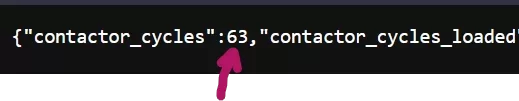

If you know the IP address of your Tesla Universal Wall Connector on your network, you can monitor the number of contactor cycles by following these steps:
  1. Navigate to http://ip_address/api/1/lifetime in your web browser, replacing ip_address with the actual IP address of your Wall Connector.
  2. Check the contactor_cycles value before starting a charging session.
  3. Check the contactor_cycles value again after the charging session is complete.
  4. Observe whether the 'contactor_cycles' value increases rapidly. During abnormal operations, the 'contactor_cycles' value should increment by approximately one every +/- 70 seconds. In normal operation, it should increase by one after each charge completion.
Doesn't look good considering this was all setup earlier this week, the cycles are very high
{"contactor_cycles":884,"contactor_cycles_loaded":1,"alert_count":150,"thermal_foldbacks":0,"avg_startup_temp":0.0,"charge_starts":884,"energy_wh":29033,"connector_cycles":8,"uptime_s":273314,"charging_time_s":25735}
I'll have to compare with time and I have a 1772/NACS adapter on the way to test as well.
