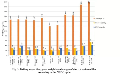

@craze1cars you gave me an idea and I found some academic mumbo-jumbo with reference to passenger cars, which does the exact type of analysis that @R P is looking for but not with trucks. I guess if I spend some time I can actually understand it (but I am not going to do it). Here are the reference to the two articles and nice graph (there are several more in the article).
The Tesla S has a high curb weight, heavier battery and long range. The Renault has a smaller battery, range comparable to Tesla but a much smaller curb weight. I do not know how to convert this to diesel and to account for actual loads. I am not sure that dynamo-meter with no load will provide much information as there is battery weight, curb weight, towing and carrying weight and range.
If you only want range per kilogram , one can calculate the range per kg of battery for each vehicle and average it. But that will not account for curb weight.

That comparison of EVs does not help the cause... On the model S, the weight of the battery of the higher range version went up a lot more than the range.
That is why you cannot have a simplistic model. There are just too many real life operating variables that cannot be ignored. Why for example did the higher range Tesla go up heavier in battery weight than the range? There must be a reason, I do not know what.
OK, since my Kona comes in both the 39 and 64 kWh (which is what I have), I did a similar range/weight comparison. Turns out the results are opposite of the Tesla S, and what I would have expected.
The 64kWh version has a range of 546 kms (NEDC) while the 39 KWh has 345 kms. That's 58% increase in range. The 64 weighs 1685 kgs, while the 39 weighs 1535 kgs, which is only a 10% increase, and I assume is all in the extra battery weight.
https://evcompare.io/cars/compare/?..._2018-vs-kia_soul_ev_2014-vs-kia_soul_ev_2018
So, compared to the Tesla it seems the Hyundai battery technology is a lot more efficient than the Tesla's. Or is it something else.
I know rolling resistance is a big factor, but generally speaking per weight, larger vehicles are more efficient. That's why we haul stuff around in large semis and trains.
However, and this could be a major obstacle, too. Very, very large batteries might indeed be less efficient, because they consist of many, many small batteries (eg 18650's) which all have to linked together in parallel and series to provide the appropriate voltage and amps. That could mean a lot of extra BMS (and TMS) to keep them all working properly. Not too mention the greatly increased rate of failure (when even just 1 cell fails) and risk of fire. Maybe Musk is waiting for new battery technology to become usable to overcome this obstacle.
