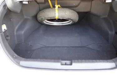

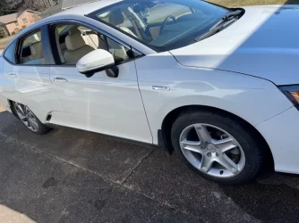

I have had anxiety with no spare on road trips which I do weekly. I researched the hub size etc on wheel-size.com and after finding a 2005 acura TL in the junkyard with a 17" wheel I decided to give it a go. https://www.wheel-size.com/size/acura/tl/2005/
The backspacing was shy of 5mm but I figured I could get a wheel spacer if the tire rubbed but it did not. Luckily I also found from tire specs on tirerack.com that a 215/55/r17 has the same circumference as our stock factory tires. Double lucky is this TL had that size on it and the locking lug was absent!

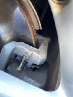

Eighty six dollars later in fees etc I had it on the car and it fits, is hubcentric like our factory 18 wheel and easily clears the front calipers. I drove with it on to lunch and back and could not tell any difference, the steering wheel stayed straight with no pull and no issue with 70 mph speed limits.

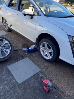

With a low profile harbor freight jack and battery impact I can swap it in about 8 minutes including putting up the tools back in the trunk. I highly recommend the beefier jack and battery impact wrench if you don't mind carrying a little more cargo. Much easier to change a flat this way.
Jack: https://www.harborfreight.com/autom...minum-rapid-pump-racing-floor-jack-64545.html
Similar Impact wrench to my milwaukee: https://www.harborfreight.com/20v-c...and-case-64195.html?_br_psugg_q=impact+wrench
