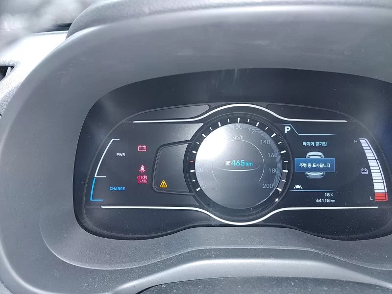

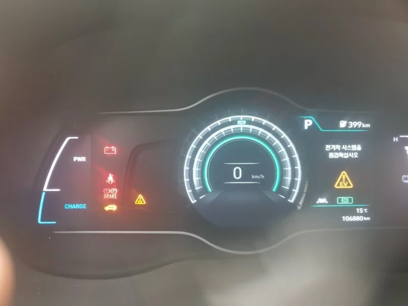

After BMS update (15-oct-2020) by automaker then some KONA stop and comfirmed will need to be replacement whole hi-voltage battery pac at korea.
* Photo = 7th & 5th KONA
View attachment 9622 View attachment 9623
I had the same message at the fast-charging station and 12V battery replaced because it is a fault, the gear not connected, after the message coming again the same situation and then replaced HV battery. Kone 2019 drive 73 00 km. After both batteries replace all work well, hope that the new HV battery works better than the original. Maybe the same error message can mean a different, have to check the battery by an office service station and if the battery is fault importer maybe report factory and so on.

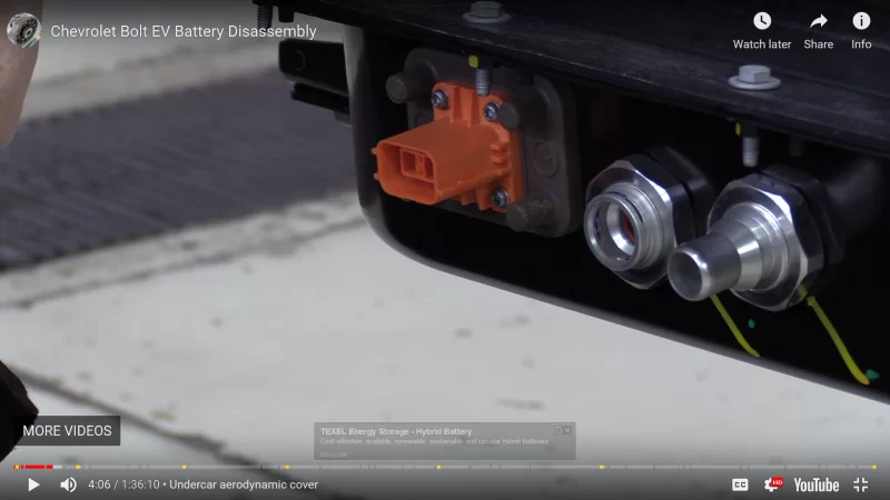

Not sure it is relevant, to our Konas but on the Bolt forum there is talk about a First and Second Design Battery. The Second Design batteries have a female and a male connector for battery cooling - see picture. The first design used two female connectors. Speculation is that Bolts built with Second Design battery are OK. But no one is sure.
View attachment 10707View attachment 10707
Chevy Bolt had a upgraded battery before with increasing range right? Something related with new chemistry inside the battery.
My Kona is now chang the original fault HV battery to the new one but I not know is that new battery exactly the same as the original was. I hope that the new one is improved maybe. I am interested in that kind of information for the new replacement batteries for Kona.
