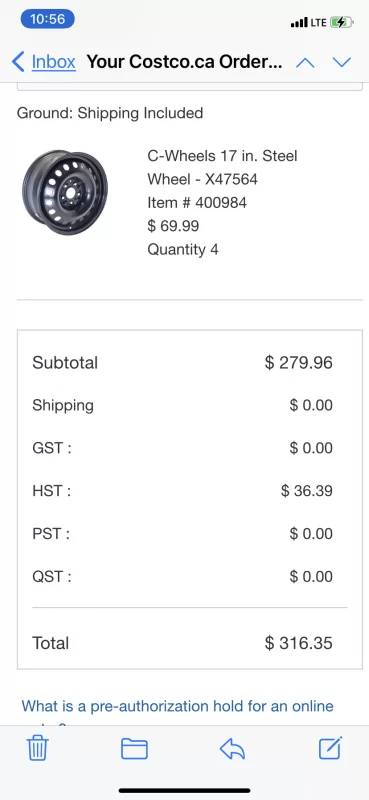

Got winter tires on steel rims at costco, they had no issues getting the right ones.
The c-wheels page shows a Costco Wholesale logo, so that's probably the wheel that Costco sold you.
