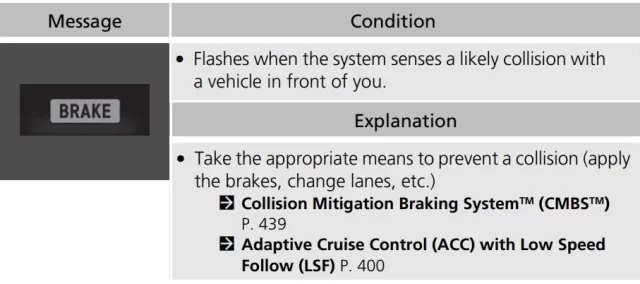

Actually something more permanent would be nice although I would prefer a small LED light rather than a noise. Then again it may turn out that the large orange "Brake" warning that displays on the dash coincides with all automatic brake light activation, although the manual is a big vague on this.
This is the "Brake" message I am referring to, although it's not clear from the manual if this message is always associated with CMBS and ACC brake activation. In other words can this message sometimes appear even when the system is not applying the brakes?

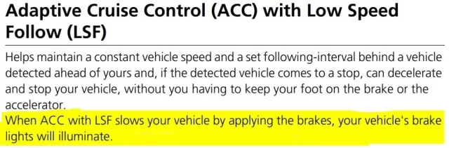

In the ACC section it mentions that the brake lights are activated when the brakes are applied by ACC
But will this always cause the "Brake" warning message flash?
No mention about brake lights in the CBMS section but it's hard to imagine that it doesn't activate the brake lights when it applies the brakes.
No mention that I could find about paddle regen activating the brake lights, so my guess is that it doesn't.
