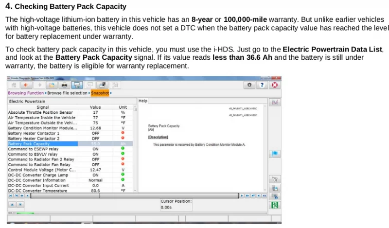

The range estimate *is not* the battery capacity. Are these numbers from reading your odometer? More importantly, are they from the same time of year? Range *will* drop in winter.
I have to agree with your assumption on the battery warranty claims as it's not clearly defined and ambiguous.
What is not clear about this (from Honda SP 17-093)?
Also, as I said earlier, you simply cannot interpret range as a direct measure of battery capacity... There are just too many variables that cause range to vary quite dramatically with no change in actual battery capacity. The vehicle measures the battery capacity and that's what Honda uses to determine warranty eligibility. A competent dealer (if there is such a thing) can read this number from the vehicle, OR you can do it yourself if you are technically inclined.
The Honda warranty allows for a much greater loss of capacity compared to almost every other warranty with which I am familiar.

A battery warranty (years/miles) is really useless without a specified failure threshold, and it lulls consumers into a false sense of security.

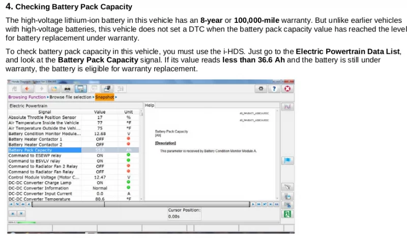

I service department was able to provide the information based upon the service bulletin #17-093 and my battery pack capacity is at 47.1Ah. Still way above the 36.6Ah as outlined. Thank you again for all of your help and walking me through this.
