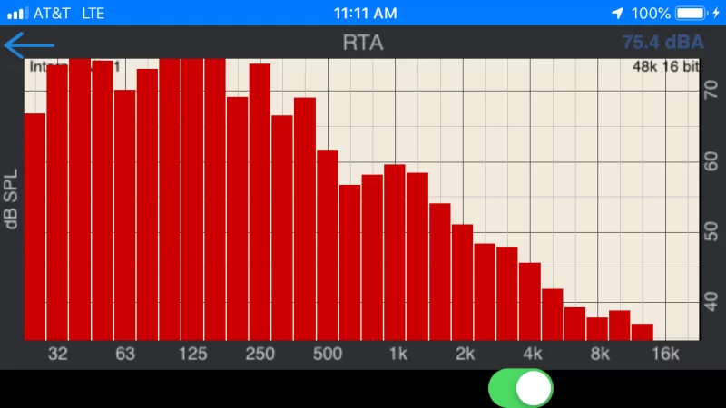

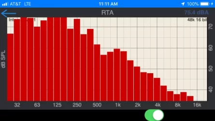

So, I thought I had the RPM's figured out... I just drove I88 backwards, and had higher RPM's: It never settled into the stable RPM's. When the RPM's went over 4000, the cabin noise seemed loud, so I turned on my sound analyzer. Cabin was up around 80 dB.

My experience is that there is a big difference in need for higher revving ICE between fully loaded car and driver only, and between going 60-65 and 75-85. With just me, no luggage, and interstate speeds in 60-65 range, the 4-banger noise is not objectionable (Kentucky Ken mode). With 4 adults, trunk full of luggage, and 75+ highway speeds in northern VA on Christmas trip, the ICE seemed to be in 3000-3500 RPM range, with family members asking if car was OK. But was perfectly logical as the energy has to come from somewhere.
I took back roads across the mountains yesterday coming home from NC, and used paddles and sport mode. Was not at all like the fun of driving a sport sedan where engine sound is tied to torque and acceleration through turns, but the car handles surprisingly well for a 4000 lb family sedan (while getting 40+ MPG) and I just turned up the radio to mask the CVT-style engine sound.
As stated in above posts, the engine sound is really dependent on your driving mode.
