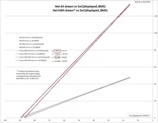

You can't trust the GoM to indicate battery capacity but rather have to carry out a capacity test. I did that twice on my original pack and came up with the advertised 64 kWh and 180 Ah.

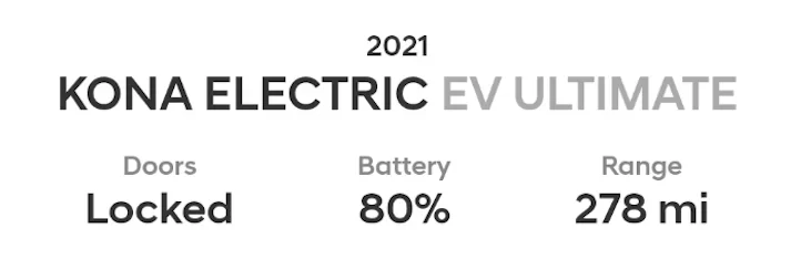

I've charged my Kona to 80% twice more since the BMS update last month and the GOM range has, not unexpectedly, dropped from the 278 miles on the very first charge after update to 256 miles after this last one. One additional thing I have noticed is that the drop in range has increased noticeably when I turn on front defrost. Before the update, when I'd turn on the front defrost with temp set at 82F, the drop in the GOM was usually ~35-40 miles. After the update, the range drops ~60 miles. I thought I was imagining things the first time I turned it on, but it's been consistent.
