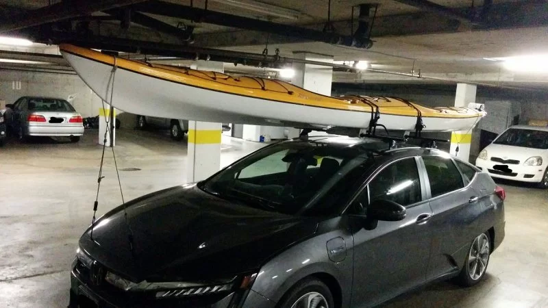

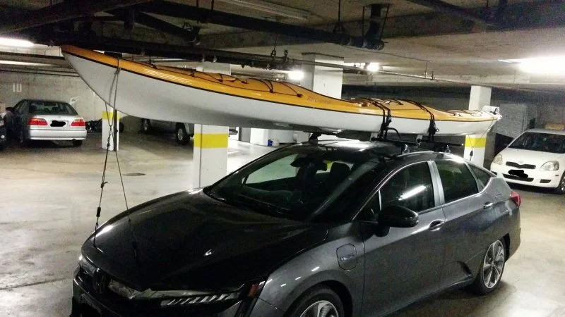

Finally ready to go for a paddle, Thule 54" custom install tracks, Yakima Skyline'sView attachment 4209 on Landing Pad 1's, and 50" Jetstream bars, Thule 530 Quick loop straps (under hood).

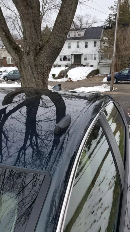

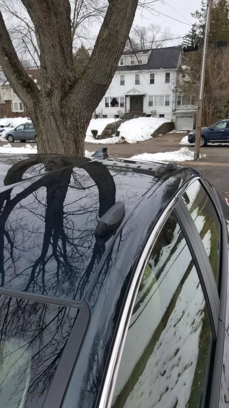

It's too bad these tracks look kind of ugly. If they made nice silver ones I would feel much better about drilling into the top of my car. But it would make the car so much better for road trips!
Yvar and others - have you experienced any loss of range or additional cabin noise with the tracks empty?
Those landing pads make any wind noise on their own? How noisy are those round bars ??

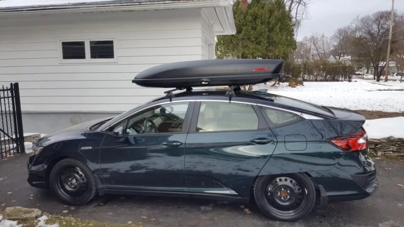

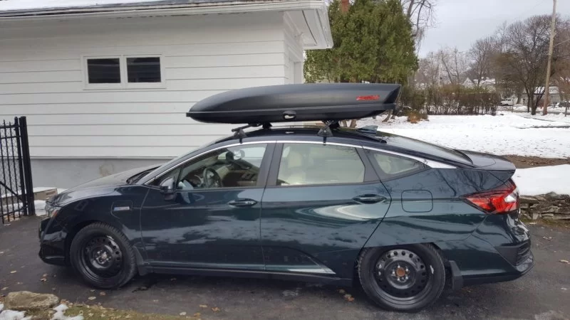

Please tell the about those wheels and tires.... They look like universal steel rims? Which would be so great!
Yakima does make rack tracks but auto-configures the Clarity for clips. As Yvar suggested you can get also get tracks from Thule and then add Yakima landing pads, towers and bars if you like. I'm exploring the track route because I like the flexibilty of positioning it affords and the fact that you can remove everything but the tracks when not in use. I’m probably going with Yakima as I have a bunch of Yakima parts and I like the fact that you can use iron pipe as crossbars of whatever dimension you like (strength specs notwithstanding). Trust in the installer is my next hurdle. What should my instructions be? I did a search for information on the steel framework such as provided by Insightman and found some on page 7 in this Emergency Response Guide. (Interestingly, it is slightly different.)

Still happy? I'd love to see close pics of the track/tower. I assume the 54" tracks the longest that can be accommodated (?).Finally ready to go for a paddle, Thule 54" custom install tracks, Yakima Skyline'sView attachment 4209 on Landing Pad 1's, and 50" Jetstream bars, Thule 530 Quick loop straps (under hood).
Nevermind. I see you already did that. Pardon.I'd love to see close pics of the track/tower.
