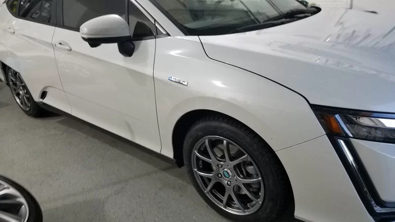

Hello,
My Enkei wheel came and it's a great fit. No clearance issues with the brake caliper; there's about 3/4" space between the brake caliper and the wheel.
The model is Enkei M52 with +50mm offset. The wheel is 7.5" wide. "Hyper Black" (oddly this is not black) is a nice match for the car, it's about the same color as the hubcaps on the stock Honda wheels.
I'll report back once I have the tires mounted.

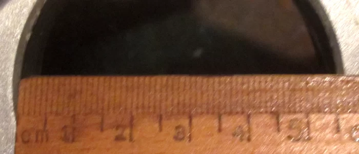

Might be 55.1mm. I don't have a caliper, just an old wooden ruler.

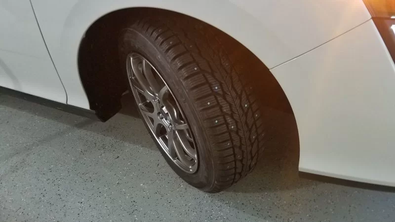

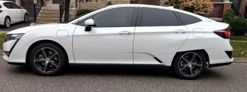

I had the studded tires mounted today and I put them on the car and we did a test drive. It drove great, just the typical sound of the claws hitting the road. We're ready for the winter.
These are Enkei M52 with studded Firestone Winterforce 2 215/55R17 all from the Tire Rack. I have 40 PSI in these.

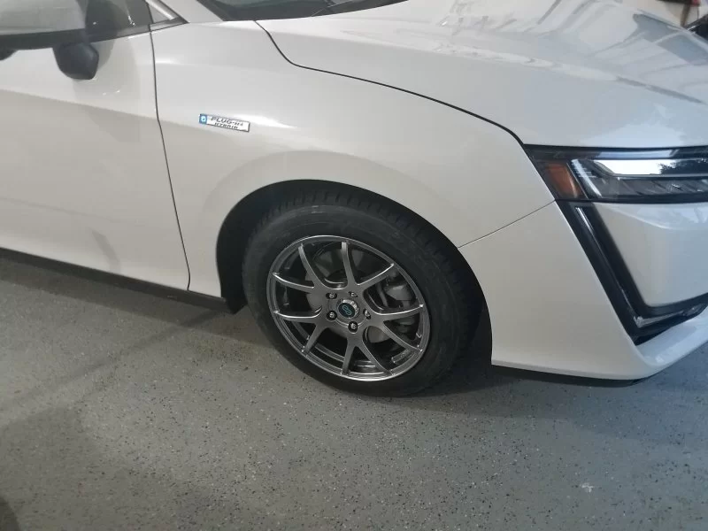

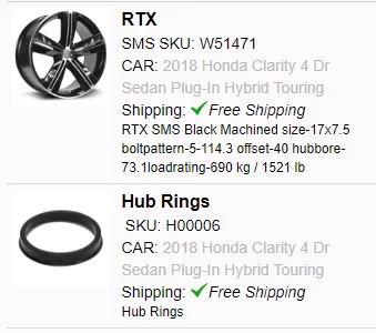

I've bought the following and have test fitted them. Everything works as expected.
Will install them once it get cold enough.
Tire:
From Costco.ca. Pirelli Winter Ice Zero 215/55R17 98H
Rim:

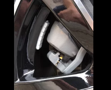

17" rims are as small as you can go. On my rims, the stick-on wheel balancing weights on the inner face of the rim just clear the front caliper with about 3/4" clearance. [The clearance depends on the rim manufacturer and they don't publish it as part of the specs. I've had issues with a brand of 17" rims on my wife's Lexus where the inner edge was rubbing the caliper.]

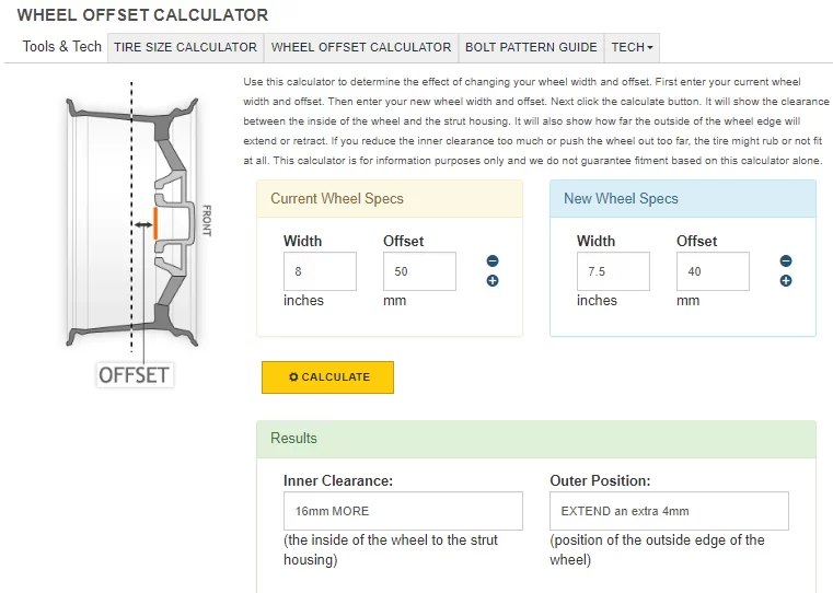

My 7.5" wide rim with 40mm offset compared to the OEM 8" with 50mm offset.
It extends out towards to fender by an extra 4mm but there are no clearance issues.
End Result:

So finally have time to check with Costco.ca on rim and tires.
I guess the 17" rim that cost $69.99 (4th one on the list) is the correct one to order?
https://www.c-wheels.ca/en/fitments...e=Honda&model=Clarity&submodel=Plug-in+Hybrid
Also check the price for Michelin X-Ice III, total including everything for 215/55R17 is $899.99 so total for tires and rim is $1216.35
