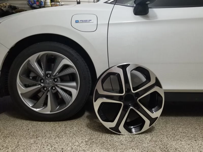

Someone in this thread mentioned Accord wheels and I found these wheels from a 2016 Accord:
https://www.wheelership.com/new-17-replacement-wheel-for-honda-accord-2016-2017-rim-64080.html
The link given is for inexpensive replicas of the OE wheels. I just ordered them and I hope they're as strong as OE. The seller claims JWL certification. Here's something on this Japanese standard:
https://en.wikipedia.org/wiki/JWL_standard
These wheels have an offset of 55mm and with 5 mm spacers they will match the Clarity's offset. Their appearance is somewhat similar to Clarity wheels. They are more than an inch less wide than the Clarity wheels, which are on the wide side for their tires. This will make the wheels a good match for the 215 width tires.

I forgot to mention that I cancelled my order for the Accord wheels because I didn't want to deal with potential scrub radius or hubcentric centering issues with a +45mm wheel. I didn't want to replace the wheel mounting studs or leave them and worry either. Instead, I've ordered a single Enkei aftermarket wheel to verify it will fit over the front calipers. This is a 50mm offset wheel and it just needs a ring to adapt the bore hole size so that it will center on the hub. If this wheel fits over the calipers, I'll order 3 more and update here.
I prefer the look of Honda wheels, even their steel wheels look great (pretty hubcaps). And steel wheels have certain benefits: they're inexpensive (except the ones from Honda) and they can bend without breaking on impact. I think police cars often have steel wheels for that reason.
Discovered I had put the wrong data into the tool on Wheel-size.com site. Here is the corrected wheel/tire for the Honda Accord replacement wheel and snow tire. https://www.wheel-size.com/calc/?wh...-17X6.5ET55&fcl=2in&wcl=1.25in&scl=2in&sr=0in
The offset is slightly off from center of the brake caliper, but well within recommended tolerence, and the scrub is almost identical to factory.
