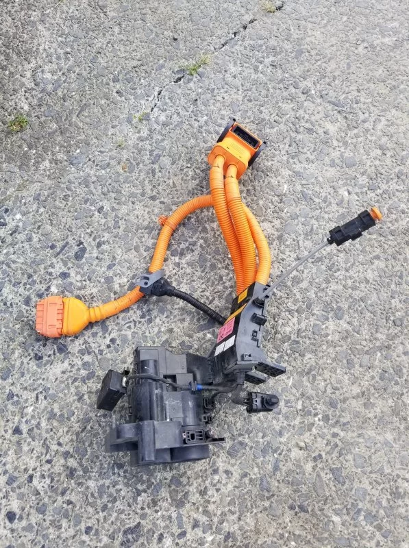

Just one note about out-of-warranty failures, a 2018 Kona owner here with nearly 150,000 km just had the charge port actuator fail and had to pay all costs, just over NZ$2100. We all know that this is a not an uncommon failure and almost certainly due to a design defect yet Hyundai accepted no responsibility. One owner in the UK said this issue was considered a recall item by his dealer.
I have this part new in the box from a Hyundai dealer somewhere, It was a couple hundred. Fixed the issue with a needle file some wd-40 and some patience.

I am looking at the picture of the 'charge port actuator' KiweMe attached to his note above. I understand that you purchased a unit form the dealer and did not need not use it. Am I correct? Where (what part) did you filed the needle nose?
Keith you lost me :(
I was referring to the charging port assembly shown. Both the door and the port have been problematic for some, including me. I bought the charging port assembly shown in the picture somewhere back in the thread, and it was only $300ish for the part, he said he paid NZ$2100 to replace it. Must be labor. I never actually put it in, I worked on the latch to keep it from sticking, I think that is what was burning up some of them, and used needle files to correct the charging port issues I kept having, the control contacts in the port were apparently not making good connection with the J1772 handle, so I cleaned them inside the connector with a needle file and some WD-40.
Thanks Keith for your response. Good description of the problem and your simple solution.

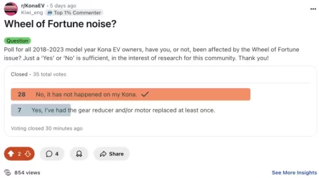

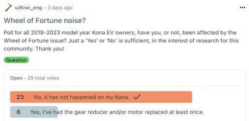

Coincidentally I placed a poll on Reddit.com/KonaEV a few days ago to answer that question for a potential buyer of an early Kona who's wisely decided to do the research before buying rather than after. Reddit is still fairly active on a day to day basis compared to the slow decline on all the other dedicated sites, presumably because EV enthusiasts have moved on to newer models.
I may have worded the post title poorly but the percent indicating having a problem is through the roof at 20% after three days. It's running one more day.
At the other end of the spectrum, based on New Zealand's fleet of some 4,000 (1st-gen) Kona EVs a high guess would be 1% and that's derived by arbitrarily multiplying the number I've seen reported by four times. Those reports have been seen on the tight-knit Hyundai-Kia EV and general NZ EV owners FB groups. I'll mention though that Kiwis tend not to raise a fuss about problems if they are handled expeditiously by the dealer and importer, and the evidence indicates that they typically are.
The fact that Hyundai-Kia have not addressed the issue makes me think that it's not nearly as common as 20% but certainly at least 1%.
BTW My dealer replaced the motor mounts, and that, predictably "was not it". So they are now on to the service bulletin's second step, replacing the reduction gear. They indicated that if that does not solve the ticking sound, they are replacing the Electric motor after that, which is USD 6K, and in the USA is currently in short supply. Fortunately for me, all under warranty.
Poll closed with a 20% WoF failure rate. But the very low number of votes (35) v.s. number of views (854) means the confidence is very low. No doubt some, or many thought the question only applied if you had the WoF.
