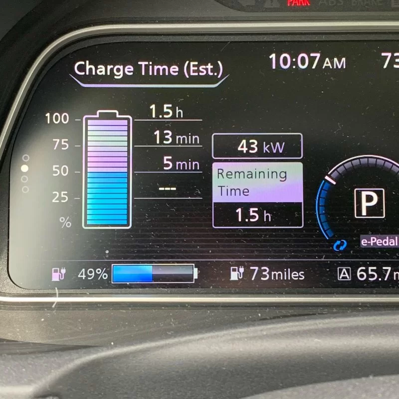

PLugshare example of time based rip off.EA up to 75kW/ $0.15 minute: 40kw Nissan Leaf at 50% will take 1.5hr to charge?! This would be 20kWh for $16.50 USD to go about 87 miles/140km [100% - 175 miles/281km.]. To deter DCFC hogging,free,or payment,idling fees would be fine once an EV gets below 7kW,an in app. warning should go off about 10 minutes before so you can get back to the vehicle to move to L2,or drive on.

PLugshare example of time based rip off.EA up to 75kW/ $0.15 minute: 40kw Nissan Leaf at 50% will take 1.5hr to charge?! This would be 20kWh for $16.50 USD to go about 87 miles/140km [100% - 175 miles/281km.]. To deter DCDC hogging,free,or payment,idling fees would be fine once an EV gets below 7kW,an in app. warning should go off about 10 minutes before so you can get back to the vehicle to move to L2,or drive on.
You discovered the real reason WHY you don't charge above 80% on a DCFC! It takes a long or longer to charge from 80-100% as it does 0-80%, and when you're paying the the minute, well, the cost of that last 20% doubles the fee. On a car with only about 80-90 miles range that's extremely expensive to get only about 20 miles more range. On a Kona the difference is around 50 miles, but still, charging above 80% on a DCFC is reserved only if you really really need those extra miles and are willing to pay big for it.
