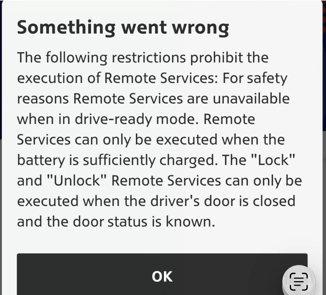

Hey guys. Been dealing with an issue since the battery software safety update with MINI connected and MINI dealership fail to acknowledge. Prior to update all remote functions worked. Now I get this error:
“Something went wrong
The following restrictions prohibit the execution of Remote Services: For safety reasons Remote Services are unavailable when in drive-ready mode. Remote Services can only be executed when the battery is sufficiently charged. The "Lock" and "Unlock" Remote Services can only be executed when the driver's door is closed and the door status is known.“

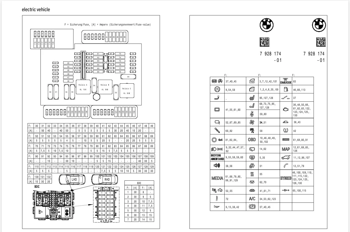

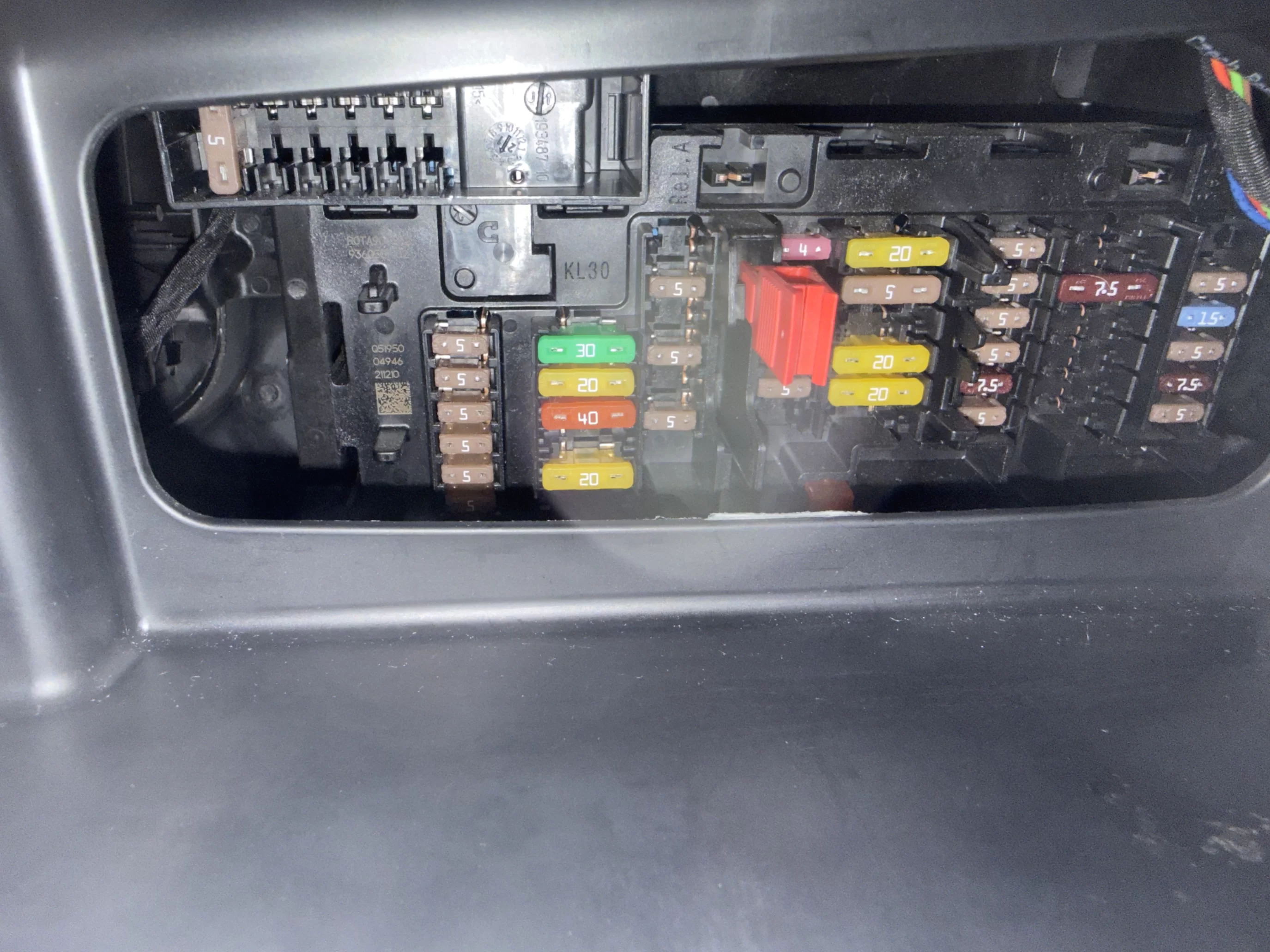

Chat GBT said to pull the telematics fuses for 20 minutes to shut it down and then put back in. Odd thing is that the fuse diagram from MINI’s website doesn’t look anything like mine via VIN. The pictorial diagram doesn’t show anything even remotely close to what would resemble the fuses needed to pull for a full reset.

Anyone have any ideas? Is there a different fuse box other than the one in the glove compartment back? ChatGBT is notoriously unreliable and hallucinates bad and incorrect info so it can’t be trusted. Here’s my diagram. ANY HELP would greatly be appreciated. I can’t pre condition anymore or get charging stats in the app, and nobody at MINI will help me. They even refused to reflash my software now that I’m out of warranty even though I reported it the day I left the dealership after this stupid battery software update that triggered this.
View attachment 28819View attachment 28820View attachment 28821 clickunder ad network
