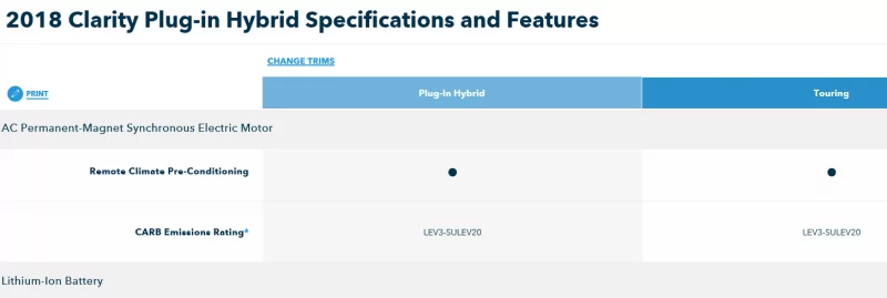

Except that it persists; it wasn't a one-time error that was fixed later. Go to Honda.com and explore the Clarity Plugin and click on Models & Specs.
Going beyond the brief comparison previously snapshotted on their site and you find the full feature list matches what owners experience. Not sure why this would be a feature to list under Electric Motor category rather than Comfort & Convenience.

Well, instead of persist you could also say never corrected. Kind of like the picture in the owner’s manual that shows 1,000s of miles of HV range. It’s still there too. What ever the case, all the base models so far have remote climate control and all the rest of Honda Link working identical to the touring models, as far as we know from posters in this forum.
