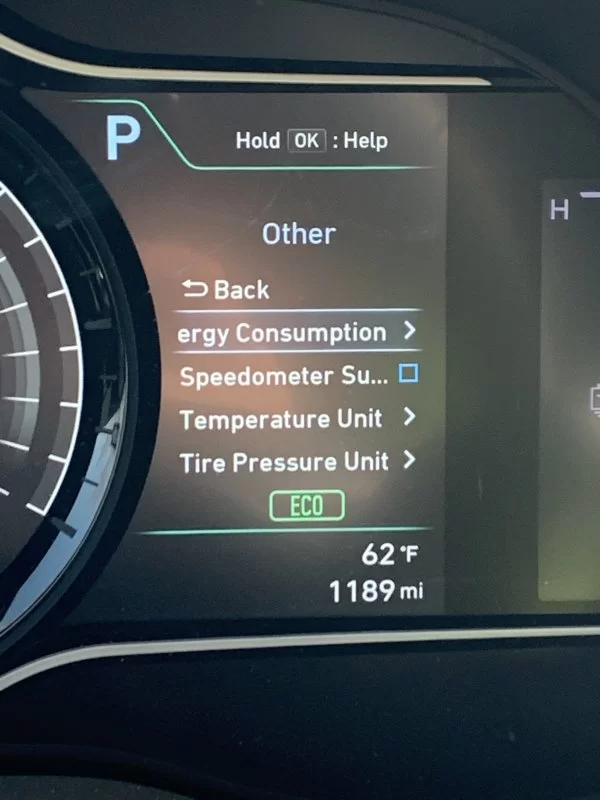

Took mine into the dealer today for the 196 update. The manager said it was not the first one they have done, even if that was a lie I felt better about it.
It took maybe 1-1/2 to 2 hours. I noticed no significant changes when I got the car back, other than no option for aux battery charger option being gone.
At this moment its plugged into the granny charger, reads 47% and 32:10 till charged (have it set to 80% for AC)
