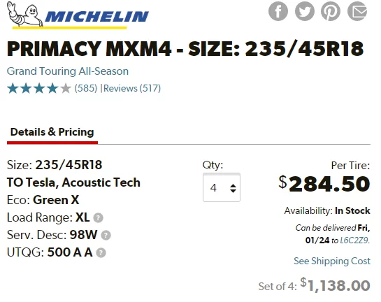

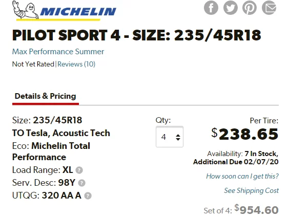

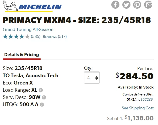

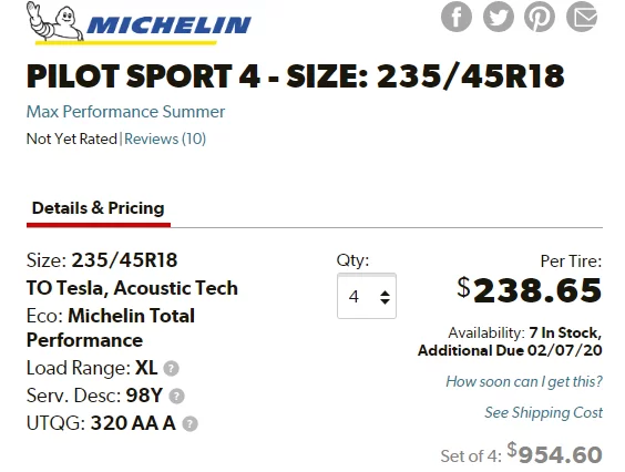

If dealing with a snowy climate is not an issue and you don't have a need for run-flats, then Michelin has 2 options I think are worth considering. I got the quotes from Tirerack.
View attachment 7210 View attachment 7211
These are specially engineered to be quieter -recommended for Tesla.
IT appears that Michelin has implemented an insert called Acoustic Tech. https://www.michelinman.com/acoustic-technology.html
I'll be replacing my OEMs soon with these Pilot Sport 4 with AT for better handling at the cost of lower tread life with the softer compound @ 320. If tread life matters, then the MXM4 are better @ 500.
Lousy wear rating on the Sport 4.
