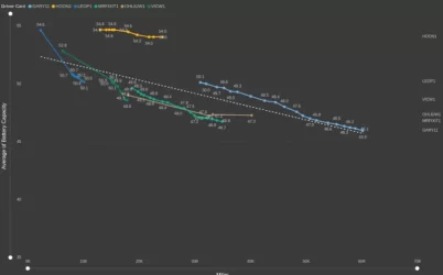

Interesting… after 5-6 months of almost daily full discharge on highway, there is almost no battery degradation…
Here you are graphically (brown) along with a few others for comparison:
It interesting that your reading went up (slightly), and then has been pretty much flat for the long interval. I would encourage you to keep taking readings (maybe a little more often). I feel like more points can better represent whatever trends may exist. I take a reading approximately once a month, but that is maybe a little overkill. Maybe every couple months is a reasonable compromise...
I have been kind of hoping that these capacity curves might flatten out over time. I don't feel like we have observed flattening in general. Yours 'appears to be flattening, but I think the data is a little too sparse to draw any conclusions yet.

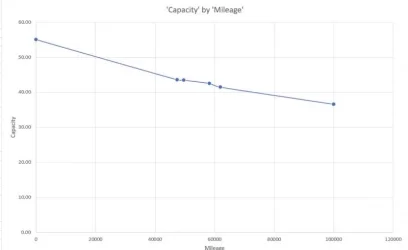

I routinely get around 30-32 miles of range on the battery now vs about 40-42 when my car was new. If the capacity drops to 36.6 before 100K miles I'll be eligible for a replacment under warranty. I'm not sure why mine is doing worse than the typical Clarity. As I became more knowledgeable about Claritys, I realized that the unit I bought was manufactured in Feb 2018. I bought it in Nov 2018. In the meantime, it was sitting on a dealer lot outdoors in Phoenix and I doubt that the dealer maintained it. In addition, it's routinely operating in a hot climate and most days I use 100% of the capacity. I estimate that it has around 1000 full charge/discharge cycles on it by now, so some degradation is to be expected, but this is more than I would hope for.
The beginning point of the graph is the nominal new capacity at 55 Ah. (I don't know what mine was when new as the dealer didn't provide me with that information and I didn't know enough to ask for it). The end point of the graph (at 100,000 miles) is what the warranty covers. Based on the four data points I have between 43K and 62K miles, I'll probably be just a bit above than the minimum when the warranty expires. [/ATTACH]
@Miles777
Thanks for joining us in gathering HV Battery capacity data.
I am not sure it is quite fair to extrapolate with a straight line like this, but hopefully all of the user data will give us a better idea of how this curve plays out. It is certainly hot in your area, and perhaps that could account for some additional degradation.
Please continue to supply data periodically. There will be a lot more Clarities reaching higher mileage as time goes on which will better refine our average curves.
Agreed - the mileage vs capacity curve will probably flatten instead of being the straight lines shown in my simplistic chart. However, the loss of about 25% of my range is real. I can no longer make trips on the battery to places that used to be within easy range.
Yes, I've been providing data and will continue to do so. If you look, you'll see that my data points are the outliers (at the bottom on the main graph) in the 40 to 60K mile region.
