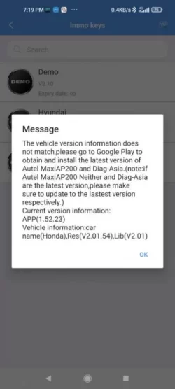

Anyone having issues with AP200 with beta version? I tried to use it today on my clarity and got the following screen, clicking ok takes you to google play store and there no updates available. When you click Open from play store it brings back to the MaxiAP200 app and it is going thru the same loop.

I just reinstalled the app and it is back to version 2.01 not getting the beta version 2.01.54 and obviously it is not reading the battery pack capacity.
I conveyed your problem to Autel. This is precisely the symptom that they claim to have fixed.
If / when they respond, I will report back,
In the meantime, keep checking every few days, there have been multiple occurrences where functionality just returned on its own.

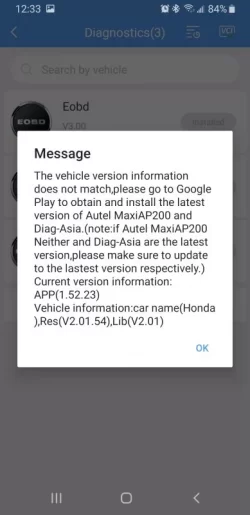

I tried yesterday and i have the same
Sent from my M2007J3SG using Inside EVs mobile app
Still waiting for a response about @Rangavasu, who has the same problem. I sent another message this morning informing them that you are also having the same trouble. They are often not very responsive. I wish this could be solved once and for all.
Having the same issue. Message "... vehicule information does not match...". Uninstalled ap200 and erased data/cache to make a clean install. Honda Clarity module revert to version 2.01. No more beta version!
I've had the same issue a couple of times now. All you can do is cross your fingers and wait, hoping that the beta version gets pushed from the server to your device at some point. That is what happened for me the last time. It took a couple of weeks.
Sadly, this seems true. I usually report when a forum member has this issue to Autel.
Lately, I just don't seem to get a response any more.

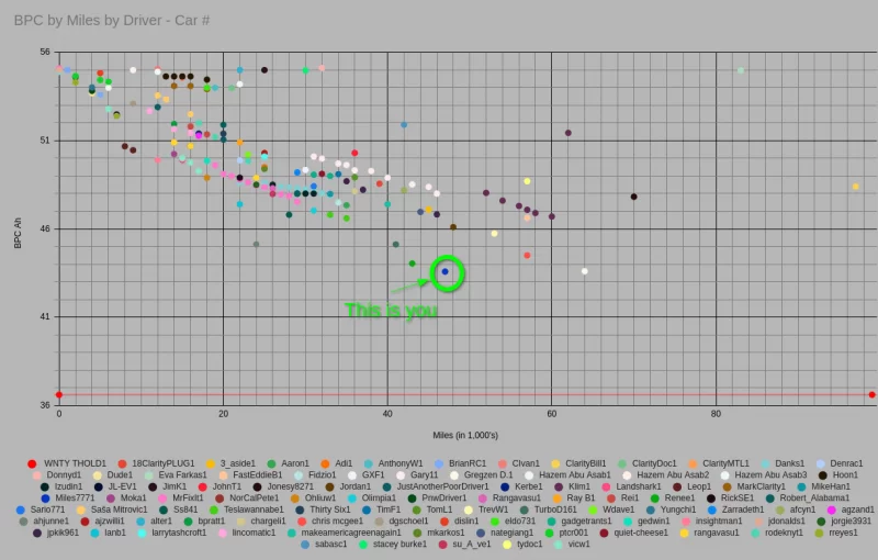

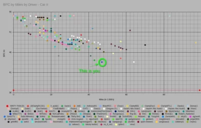

Today, I checked my battery capacity for the first time using these tools. My battery capacity reading is 43.58. That's a bit on the low side, isn't it?
Welcome to the Forum !
As you may have read, we have a shared spreadsheet where forum members have pooled together a lot of test results. From this spreadsheet it is easy to see how your Clarity is 'stacking up' to others with similar age / miles.
I took the liberty of adding your measurement to the spreadsheet (from the data you provided), and here is how you compare to others:
Our data is somewhat limited with vehicles that are in the 50K miles realm. My eyeball says that 46 Ah would be more 'typical' for a vehicle with your mileage. However, your reading of 43.58 is 95% of what I would consider 'typical', so I wouldn't be too concerned. I would encourage you to keep monitoring this going forward, and help us learn more about these trends. I track mine every month or-two.

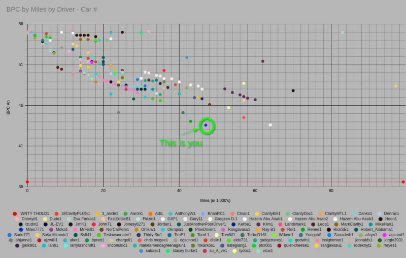

Thanks for the quick response and for compiling the data. As I thought, my battery capacity is a bit on the low side, about 80% of the original capacity. That means I have the dubious distinction of the lowest (or second lowest?) measurement in the data base!
The Guess-o-Meter battery range numbers have slowly dropped from mid-to-low 40s when new to mid-to-low 30s at present, which is also about a 20% reduction, so this indicator is consistent with the capacity measurement. I'll make capacity measurements from time to time to see what the trend is like from here on out.
