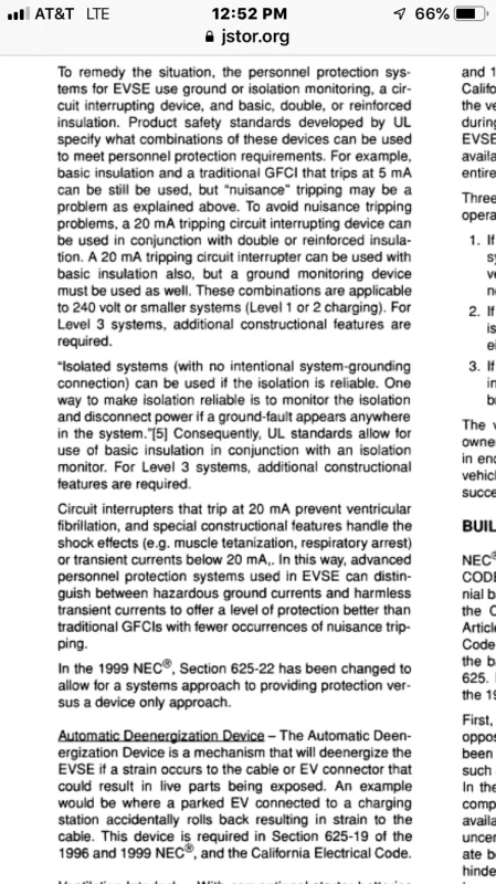

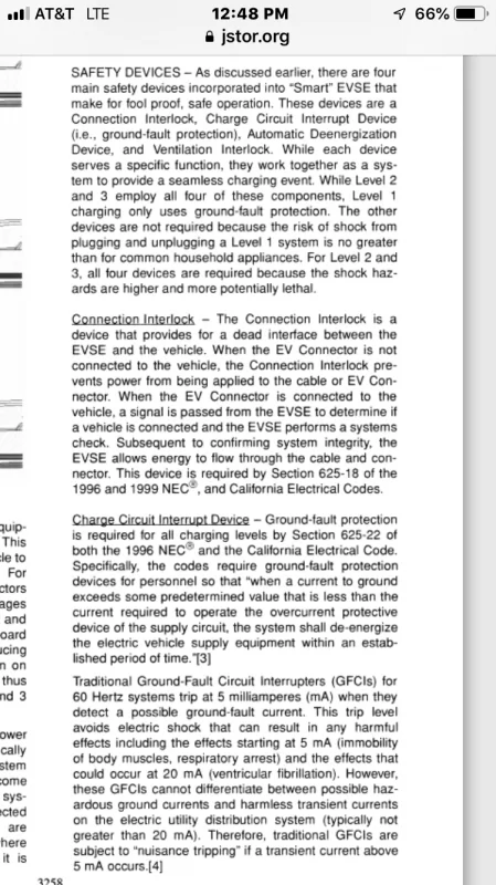

Also, we human beings are protected as well by the Charge Circuit Interrupt which senses ground current flow and the Connection Interlock which de-energizes the cable and plug. Coupled with the physical design of the prongs which have recessed electrical conductors, it’s designed to make it practically impossible for any rational human being to electrocute themselves.
The result is that the cable from EVSE source all the way to its recessed plug contacts is always de-energized unless the plug is fully inserted into the car’s charger port for the EVSE to receive the OK signal to furnish power. The reverse is also true in that before you even get the plug out of the port it’s also de-energized. This is accomplished by having the communication conductors shorter than the power conductors so that even in the middle of 240 V, 7 Amp charging, the loss of signal happens before you can unplug and power is cut off. A side effect of this also prevents any high voltage arcing since the power is alway off whenever a power contact is made or broken.
And note that the recessed conductors are individually enclosed and protected by the outer round part of the plug that goes inside the outer part of the receptacle on car. That’s a lot of physical and electronic redundancy and protection from rain. (And as much protection from stupidity as possible.)
So the J1772 safety standard has physical, electrical, and software designs to prevent harm to people or EVs even in the rain. Based on this, I’m changing my mind and charging in the rain if I need to away from home.
Since I try to refrain from just giving my personal opinions when safety or money is at stake, I’ve included some sources for the above (these also have some good EV info) and two screen shots from the SAE article that describes the 4 safety features of the J1772 (not all are applicable).
After going down this rabbit hole of charging safety, I’ve come to realize that the larger concern is not at the J1772 plug and port connection at the car but rather at any and all connections made to the EVSE. Particularly if the EVSE is not hard wired. As several posts have shown, there is much more potential for trouble there than at the car. For example we have had reports of overheating at receptacles and plugs, and water (rain) problems by not having all connection from the EVSE to the grid weather proofed. And that means protecting not just the receptacle but also any connections created by using an extension cord. Also, extension cords have to be sized for Ampacity and used correctly while the charging cable is plug ‘n play thanks to the J1772 standard.
To that I would add: There is a mechanical release button on top of the plug that you have to press before you can pull out the plug. Depressing this button (on mine, anyway) immediately de-energizes the charge system. You can tell because the green charging light in the charge port extinguishes even if you don't pull on the plug. I don't know if there are any other sensors to check if the plug is in the socket other than the low voltage square wave signaling system.
