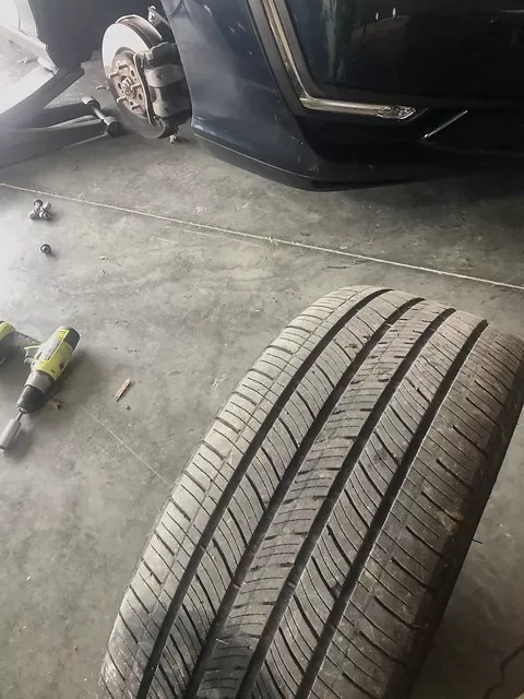

As an update, we just hit 30,000 miles on our 2018 Clarity, and I just finished our third tire rotation.
For those paying attention, this time was front-to-rear.
I’ve always tried to keep tire pressures at 36 psi, and I think that’s resulted in pretty even wear so far:
If all goes well, I’m hoping for at least 40,000 miles and, hopefully, one more rotation.
Wish me luck!
