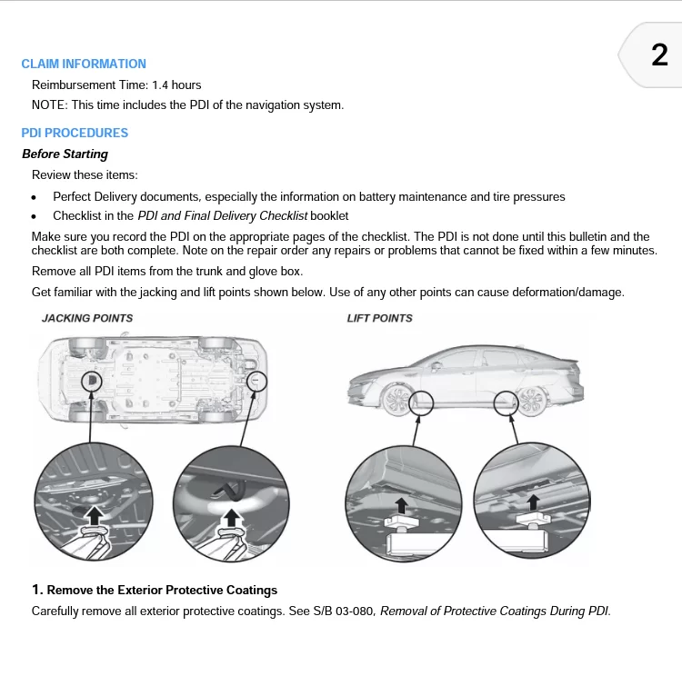

Thanks. Though when I click on your link, I just get the a pdf of the whole Owner’s Manual, and all I can find there are the side jack points. A screen shot maybe?
Your wish is my command, O King of the Skies.
But the jack points are Honda recommended and I can’t see any undue stress from using them and jacking with either the front or rear lift points equally supported. That would appear to me to not put as much torque on the uni-body as jacking from just one lift point on one side which tends to raise one side’s tire a little before the other one.
It wasn't the jack points that were the concern. The concern is you will have the back of the car sitting on jack stands, presumably the jack stands being placed at the two rear lift points. Then you are going to jack the front of the car, which causes the entire weight of the vehicle to pivit on the rear jack stands as you get the front of the car high enough to change the front tires. The same in reverse when you lower the car back down. Thus there will be moments during those two rotations when the lift points will not be sitting flat on the jack stands. I have done this and did not really like rotating the car on the two rear jack stands. Maybe it's perfectly fine and won't damage the lift points, and maybe there is no real danger of the jack stands tipping over due to lateral force during the rotation, assuming you have good jack stands and have placed them correctly. But I just felt better about lifting one side of the car at a time and so that's what I started doing. I used two scissor jacks, partly because I only have one floor jack, and also with scissor jacks you can evenly raise and lower the side since you are doing a small amount at a time when turning the handles. Someone with two floor jacks and who uses them all the time (like craze1cars) would probably find it faster and easier to use two floor jacks to lift each side, but for me it doesn't take that much longer with scissor jacks and I am not in a huge rush. Perhaps there is some risk to lifting one side of a car with two scissor jacks even if you keep both of them at even height at all times, but it always seemed stable enough.
It wasn't the jack points that were the concern. The concern is you will have the back of the car sitting on jack stands, presumably the jack stands being placed at the two rear lift points. Then you are going to jack the front of the car, which causes the entire weight of the vehicle to pivit on the rear jack stands as you get the front of the car high enough change the front tires. The same in reverse when you lower the car back down. Thus there will be moment during those two processes when the lift points will not be sitting flat on the jack stand. I have done this and did not really like rotating the car on the two rear jack stands. Maybe it's perfectly fine and won't damage the lift points, and maybe there is no real danger of the car jack stands tipping over due to lateral stress, assuming you have good jack stands and have placed them correctly. But I just felt better about lifting one side of the car at a time and so that's what I started doing. I used two scissor jacks, partly because I only have one floor jack, and also with scissor jacks you can evenly raise and lower each side. Someone with two floor jacks and who uses them all the time (like craze1cars) would probably find it faster and easier to use two floor jacks to lift each side, but it doesn't take that much longer with scissor jacks and I am not in a huge rush. Perhaps there is some risk to lifting one side of a car with two scissor jacks but it always seemed stable enough.
OK, I see what you’re getting at now. The angle being font to back on the lift points whose surfaces are longer front to back might transfer the weight to a single point on the jack stand and deform the contact point?
I went and checked and I’m not seeing any deformation or even a scratch there. The angle invoked seems very small and I have hard rubber grooved hockey puck like pads on the jack stands. But I hadn’t thought about that possible problem and I will keep a look out for it at the next rotation.

It's probably fine and as you said you didn't see any damage and neither did I, I just decided I preferred to use a different method since in the end the amount of time required wasn't that much different for something done only a couple of times a year.

How did you find and align the jack with the front point? My floor jack rolls under there fine, but I did not see the exact jack point. Might just have to go under there a bit with a smartphone camera or light with Clarity on the tires to try to see it.
Used four corner points (as per manual) okay (one at a time) last time I changed out all four wheels, but I'd like to try the center points next time. I don't think I want to go as high as my jack stands for just swapping summer/winter wheels, but it does seem like the center points might be a convenient way to lift the front or rear, then put two jack stands under those corner points. Is there anything wrong/unsafe with just putting the front or rear up on two floor stands, with the opposite set still on the ground with rubber chocks behind them?

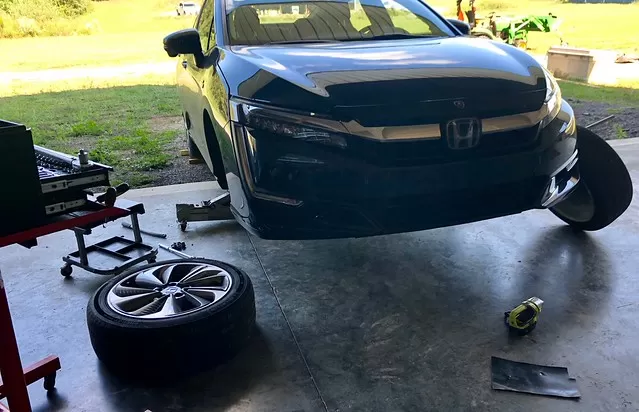

The front jack point father back than it looks at first. It’s actually slightly behind the center of the front wheels. I originally found it when the car was up on a lift and I could do a walk under inspection tour (after verifying the safety pawl was in place). I’ve used your phone-photo tip more than once since it’s hard for me to contort my back. Also works on large appliances you don’t want to move to get the model and serial # off.

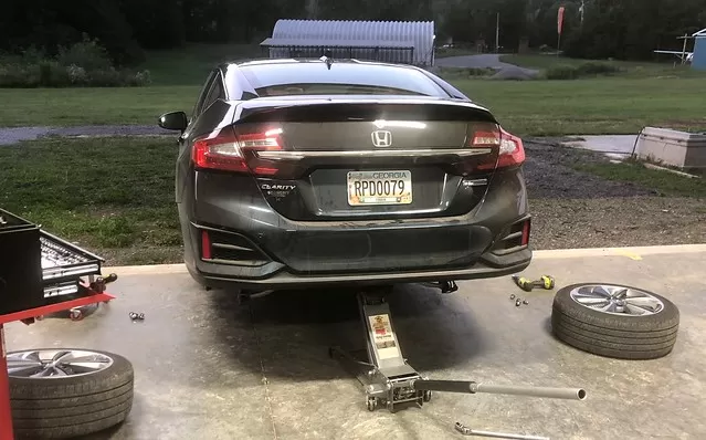

Just finished up the side-to-side rotation in the back with my larger jack:
Will tackle the front tomorrow. At 30k I’ll do another front-to-back rotation, then alternate.

My 3 ton floor jack could have just barely squeezed under the front, but I was concerned about making sure I was 100% on the jack point without being able to see it. So I just used my two jacks at the front side jack points - no biggie.
