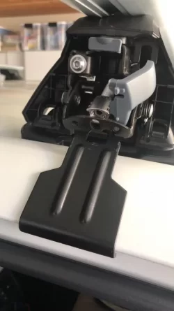

What I found was,
  • M1 is 38"
  • M3 is 37 1/8"
  • When it comes to the rear baseclips, sadly I found they are too short.
I have attached the pics of the installation guide and the rear baseclip. I have sent support emails to Yakima too.

The clips are not too short. Set M1/M3 as per instructions. The pads will not sit flat on the roof like you are trying to achieve. I have a Yakima rack that I put on and off frequently. I check the M1/M3 measurements a few times a year.
