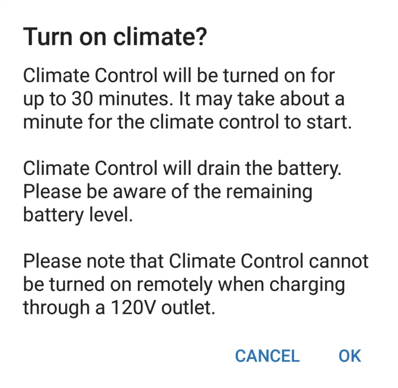

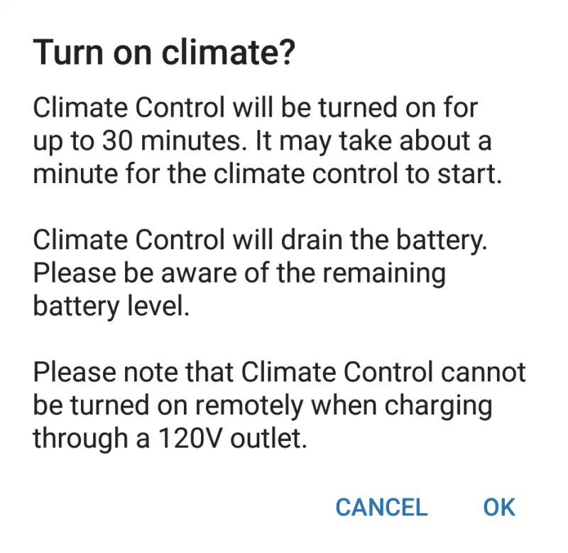

For those that have said the preconditioning now works even when connected to 120v - can you confirm HOW you got it to work? I tried it yesterday and still got this message on my phone..

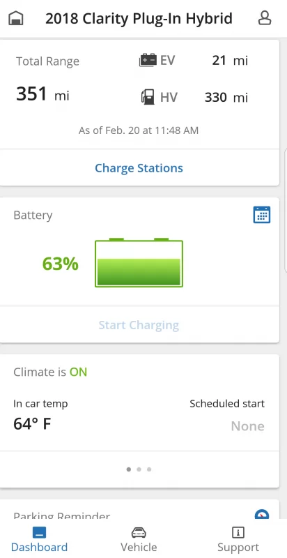

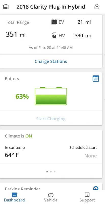

I can see your attachment now. That is a different message than I get. Here is my error message and the screen I see after the preconditioning begins:
Sorry if I was misleading. I took that screen shot yesterday to show you what it looked like while remote preconditioning. My car was parked at airport and was not charging. I now realize that you need a screen shot showing the car plugged into 120V AND actively charging, then turn on climate control. I'll try that when I get home later this week.
I just realized that in the example I sent, the car is still plugged into 120V, however charging has completed. When I precondition the car, it is in the morning after the level 1 charge completed during the night.
I actually meant to test that too and totally forgot - I just checked (currently plugged into 120v and fully charged). Sure enough, the climate control turned on just as it did for you. So the detail must be that the battery must be fully charged (or above a certain percentage) for it to work on 120v. As you can see in my screenshot above, my car was not fully charged when I tried it previously.

I believe I made two incorrect assumptions:
(1) That the Hondalink phone app would not give me a message about 120V limitations unless the car knew it was connected to 120V. (I now realize I always get this message and there is no "don't show this again" checkbox.)
(2) That the car would pull 120V power (if plugged in) to help with preconditioning. I now think if charging has completed, it only uses battery power for preconditioning.
