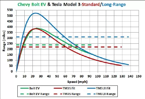

The graph below might be instructive, altho my guess is it's likely to be a computer simulation rather than based on empirical data, because so little data on the Model 3 is available:
(source: http://www.roperld.com/science/chevybolt.htm )
Actually, the difference between the efficiency curves for the Bolt EV and the TM3 is far less than I expected.

I suspect it's the AC induction motor that is hurting Tesla at low speeds. It looks like that has been fixed in the Model 3.
