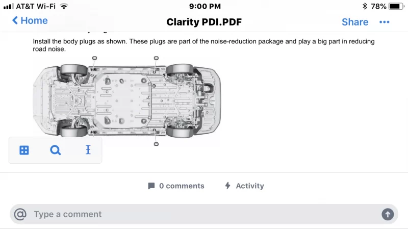

Here is an image of where they are.
I have also attached the Pre-Delivery Inspection (PDI) from which this was taken. It has a lot of interesting information and is rarely given to new owners in the USA.

Immediately upon seeing this thread, I went to check on the newly purchased Clarity. Thanks to KentuckyKen's picture, I knew exactly where to look. The body plugs were in as they should be. Also checked tire pressure and it was correct at 36 PSI. Kudos to Burleson Honda, just south of Fort Worth, TX. Easy sale. We drove 200 miles to get the car after poor experience closer to home.

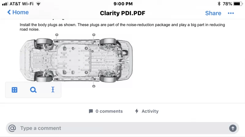

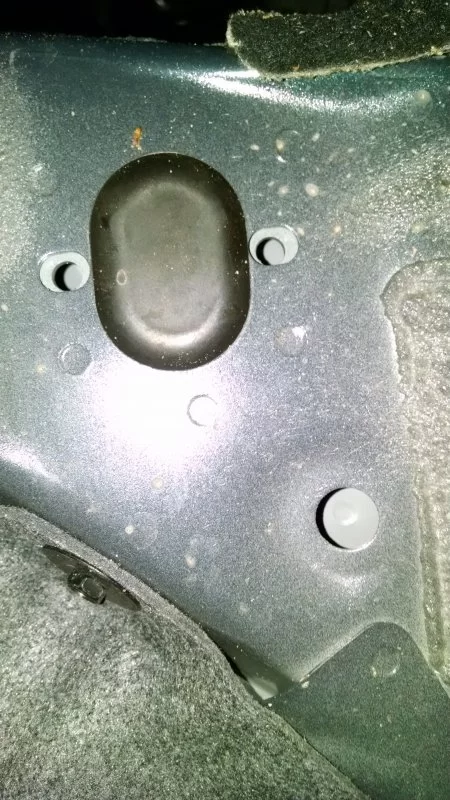

Thank you very much for this! Now, without seeming ungrateful, is there any possibility you (or another kind soul on here) could take a picture of an installed plug? It’s hovering right around -15C where I am with snow on the ground and I don’t have a garage. I don’t want to be hunting somewhat aimlessly in the cold for these...
Attached is pic for the front drivers side body plug. The plug is aprox 1" x 2" and there are four as shown in the attachment 3680 above. Not much to see in the pic as the pic was taken with the camera on the ground. Not very much ground clearance in our Claritys.
