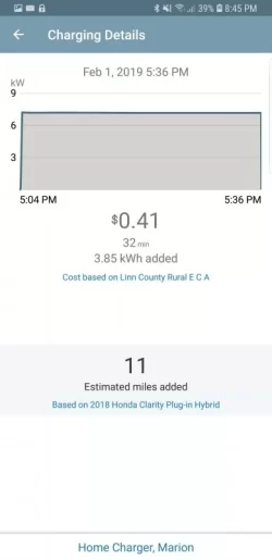

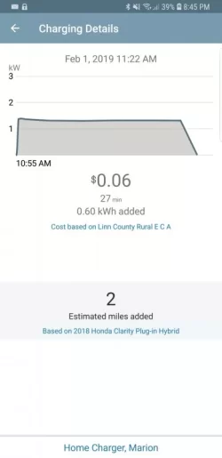

I wasn't able to drive Clarity in the super cold, but driving today after it was parked in cold garage charging was slowed dramatically. My wife had to suffer L1 charging rate of 1.4 kW for some time before the battery warmed enough to charge higher rate. This meant my wife was driving gas much of today instead of EV.
To show the difference, about the same amount of time, 5x as fast on normal L2.
