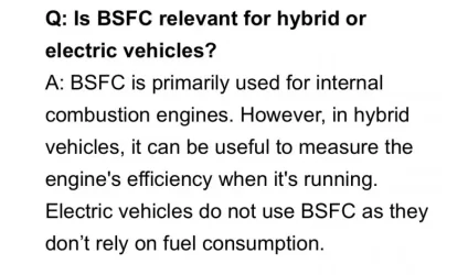

One of the important things to consider when designing a series hybrid is the brake-specific fuel consumption (BSFC) of the internal combustion engine. This is a measure of power output per amount of fuel used. Of course the engine must be able to produce sufficient power to keep the battery charged on average but also the power needed, if there is a direct connect between the generator and traction motor, to supplement the maxumum power available from the battery. The usual design is to have the engine sized to operate at the maximum BSFC when producing the power needed maintain, on average, the battery charge. This maximum BSFC operating point is also usually not the maximum power operating point but usually an operating point at less rpm.
Honda appears to have done a very good job designing the PHEV Clarity to meet the above design needs, including the use of the engine-drive-mode.

I don't believe this vehicle will have any connection between the ICE and the wheels, but I could be wrong
The engine currently specified is so much larger than required for engineering reasons, I don't think things like BSFC come into play. The engine is sized for NVH and marketing reasons, not technical reasons, but I suppose one could say that about most vehicles, since my Kia rarely uses its sub 7 second 0-60 and your 1970 average Caddy with a 500 rarely used that performance.
