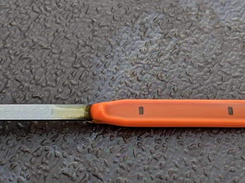

I checked it a month or so ago and I think it was about the same level. My engine runs about once a week or so for longer trips. I attached a photo of the level.
The dealer I went reported that the oil level was "within spec and that the smell was normal."
The reading on the dipstick is still above the maximum mark.
