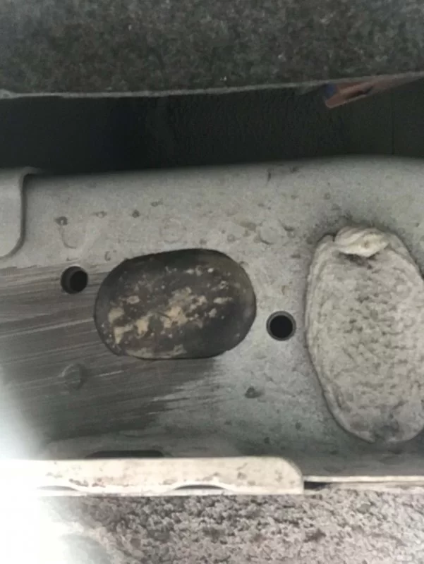

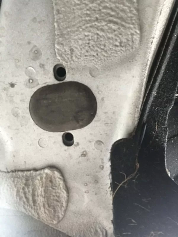

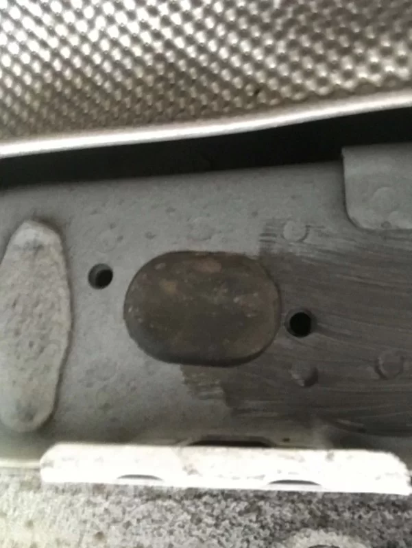

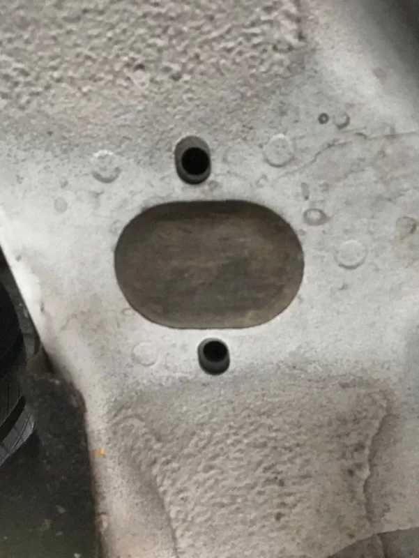

I took the car back to the dealer that I bought it from. They could not install the HV range (software) fix because their HDS was inoperative. They checked using a computer and it said there was no service bulletin needed. I asked them to install the missing body plugs and they installed them. When I checked this evening, it looked like they put on some old, used body plugs -- guessing they pulled them off another car (maybe?). It has not rained for a while and it has been beautiful and sunny all day. I am sure that I did not run over any puddles (see pictures). I believe I will try another dealership in the future.
