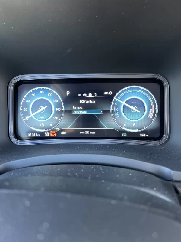

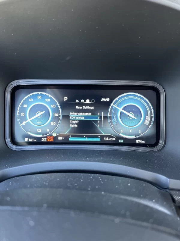

You can put it into utility mode in that move it will still supply everything with power from the battery even while charging.
Here's how to get into Utility mode:
You shouldn't leave the car on and locked. It can be broken into and driven away even if the key is not in there. I had that experience at the car wash.
Not sure what model year @duende is driving, but it may be worthy to note there are other methods to get into utility mode on the 22 MY:
and
