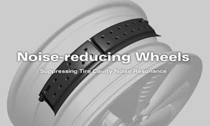

And apparently goop can ruin some TPMS sensors which is an expensive item to replace, but that depends on the type of system, I don't know about Clarity.
The Clarity compares the rotational speed of the wheels to detect tire pressure anomalies. There are no TPMS sensors in the wheels. However, the OEM wheels include noise-reducing resonators which must be a pain to clean so they'll work again after being coated with tire-repair goop.
