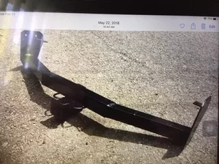

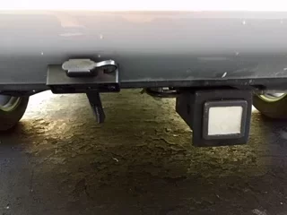

I made a tow hitch good for at least 3000 pounds. The tail pipe is routed under the hitch. It is bolted, using the holes and sleeves present on the frame. In Europe this car is rated at 1500 kg, I do not see the problem to increase the load occasionally. I bought the Mitsubishi lighting harness for $84. Well explained instructions with a lot of pics.
