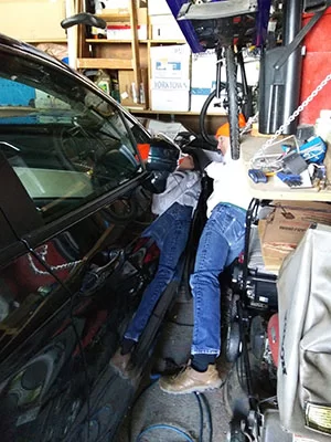

Then, after not driving our Clarity for a couple of months during the pandemic, its 12-Volt battery became discharged. The over-hanging shelves at the rear of our tiny garage prevented me from opening the hood to attach my battery charger, but I couldn't put the Clarity in neutral to push it back because shifting requires power from the 12-Volt battery. I ironically recalled the T-Bird's battery in the trunk.
Fortunately, the shelves allowed me to raise our Clarity's hood 6 inches. I propped it open with a small cardboard box and crawled along the right side of the car between it and our Honda lawnmower and Honda snow-blower to get to the front. There, I managed to contort my body enough to attach the battery charger cables. Since then I've made a point of driving our Clarity every week even if I have nowhere I need to go (yet another burden of fist-world life).

@insightman Great photo. You obviously have a family member who enjoyed the sight enough to document it.

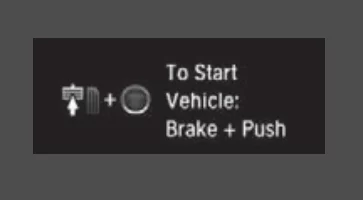

It's a very easy mistake to make so don't feel bad. When driving no one accidently leaves it in ON mode because if you do you won't be going anywhere, and anyone will realize "Oh yeah I have to press the brake pedal" (plus it tells you that on the screen).
But when turning on the car temporarily it's easy to get fooled into thinking it's running since the display fully powers up and looks similar to how it looks when running, even though there are some differences, like the aforementioned warning message as well as some warning icons like check engine, etc. and also the absence of READY on the display. However someone who is not looking directly at the display probably won't notice any of this, which is likely if you aren't going anywhere soon.
If you have your seatbelt on when you put the car into ON mode you will immediately see the warning message shown above. Which again is the scenario where you are getting ready to drive off. However get this, if you don't have your seatbelt on, which is likely if you got in your car and plan to sit for a while, then after powering into ON mode you first get a fasten seat belt warning for the first five seconds, only then followed by the message to press brake to power on. But by then you probably won't be looking at the display. They should change that as there is no reason to display a seatbelt message in ON mode since you won't be going anywhere, it should go straight to the press brake to power on message. If the driver does then press the brake and power on then it can give a seatbelt message.
And if you open the car door to turn on the car, which is another likely scenario, for example there is a passenger who will be remaining in the car like in your case and you realize after getting out of the car that you want to turn the car on for them, in this case after pressing the power button and putting it into ON mode you get a door open message for the first five seconds, which you will of course ignore since you obviously know the door is open, this is followed by five seconds of seatbelt warning (even though you aren't sitting in the seat, plus again this is ON mode so seatbelt is not needed). Only after those two messages appear does the message to press brake to power on appear. Of course by that time you are well on your way into the shopping mall.
By the way the reason that I always capitalize READY is not for effect, that is how it appears on the display and is also how they word it throughout the owners manual. And ON mode is capitalized in the owners manual also. This topic is confusing enough, so for consistency I just stick with how they show it in the manual.

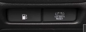

The Hyundai Ioniq hybrid (the regular hybrid not the plug-in) actually does have a feature that lets you do sort of a "virtual" jump start, there is a 12V battery reset button under the dash next to the fuel door button.
Although contrary to popular belief this does not use the HV battery to jump start the car. Instead the Ioniq hybrid has a small lithium ion polymer 12V battery in place of the usual lead acid battery, similar to the jump start batteries that we were just talking about although larger. The Ioniq also has a 12V battery monitoring system that operates while the car is turned off. If the lithium 12V battery gets too low it disengages the 12V from the vehicle to stop further discharge. When the owner returns to the car, it won't start. However they can press the 12V battery reset button which reconnects the 12V to the vehicle for fifteen seconds, allowing them to press the power button and start the car with the remaining charge that was preserved. If they don't turn on the car within fifteen seconds then it disconnects the 12V battery again to conserve it, and they have to press the button again. All hybrids could conceivably use this system, hopefully it is an idea that will catch on. It also reduces weight by eliminating the heavy lead acid battery.
The Ioniq PHEV works differently. For some reason it has a lead acid battery, which is odd because like the regular hybrid the PHEV's 12V battery does not spin the engine. And the PHEV does not have the 12V battery reset button. However what it does have is something more along the lines of what you were asking for. It is called Aux. Battery Saver+ (Aux referring to the 12V battery). This system also monitors the 12V battery when the car is not on, however this system is proactive. If it detects that the 12V battery is getting low, it powers up the HV system and the DC-DC converter and charges the 12V battery for up to twenty minutes, then the HV system shuts back down again. When the driver starts the car an indicator on the dash informs them that the battery saver system had been activated.
In both systems (regular hybrid and PHEV), if the 12V battery is too far gone and the car won't start then they will need to get a regular jump start.
